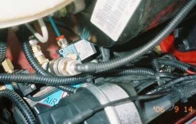

Originally Posted by JBTJ View Post
I also installed an external transmission filter to make it easier to service the transmission. Now I can do it standing up with no tools in about 15 seconds.
My 2000 Sport with the 32RH and cruse control doesn't have room for placing the add-on filter in that location and the ARB compressor sits on the tray.
So I put it in another location:
... HTH

Originally Posted by Knuckelhead View Post
My 2000 Sport with the 32RH and cruse control doesn't have room for placing the add-on filter in that location.
... HTH
Yeah mine didn't either until I relocated the cruise control unit under the add-on filter.
