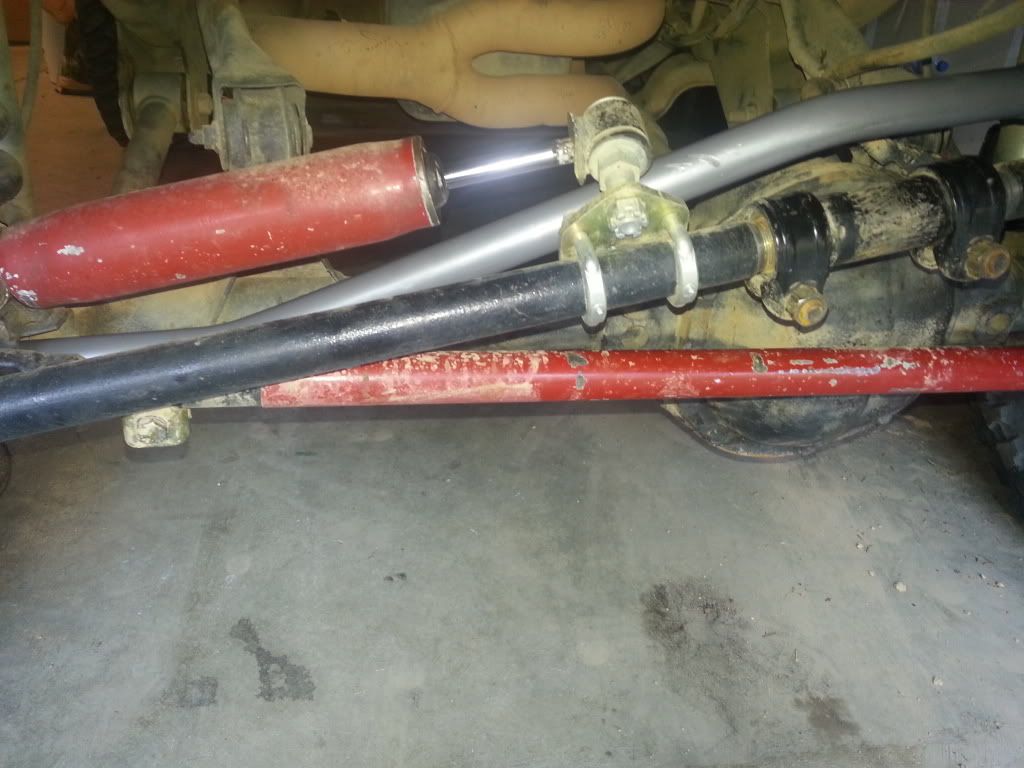

Originally Posted by 2005rubi View Post
So I took her off road this past weekend and the steering did flawlessly! Only thing is that the steering wheel is off centered...that's it. DRAG LINK IS MAXED OUT. Is it worth uninstalling and reinstalling everything??? but will I be back at square one with a off centered steering wheel. The initial instalation of the tie rod and drag link went fine and everything was right on after the first alignment. Something slipped or lossened up. Where do you suggest I start? At the steering box? The shaft? Is there a way of removing the steeing wheel with out the air bag going off?
You've bent the torsion bar inside the steering gear and it needs to be replaced.
Thanks mrblaine! I will check that next but for now I went ahead and replaced the track bar with an adjustable one and got the steering a bit closer to center...but now my track bar and drag link are not parallel to each other. Should I go back to the stock pitman arm now?

Gonna go back to the stock pitman arm and removing the stabilizer shock. What are the pros and cons of running WITHOUT a steering stabilizer shock?
Assuming all tight in your front end you shouldn't feel much difference, although you are potentially subjecting the steering components to more stress than you would if you ran one and over time that could cause parts to wear faster.
If you just replaced the track bar, and didn't move any mounting locations, and it is the same length, then the drag link and TB should still be parallel. It doesn't matter that the TB has bends in it, its about the overall angle.
I've been running without for 3 years or so..... Tie rod ends tend to become a wear item with no stabilizer.
