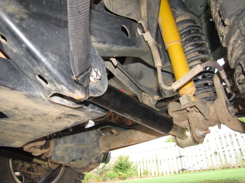

pmarascal, my Jeep did the same thing too. Wandered EVERYWHERE and it felt skittish - my wife refused to drive it.
I put on the new lower fronts to fix the castor angle and the wandering is GONE. It is MUCH more stable. My tires are aligned, so that wasn't an issue, and they have a very slight toe-in, as Jerry mentioned.
With a lifted Jeep, the castor angle seems to play more of a role in controlability. My TJ felt like this ever since I put my lift on, and I thought my steering box was going bad. But the simple solution (adjusting castor) was the ultimate fix.
You may have cam adjuster bolts on the front of your lower front control arms. You may be able to adjust them a bit to affect your castor a bit to 'push' the lower part of the axle forward a bit. With a lift, it would be a good idea.
You can see the cam bolt 'washer' by the nut on my axle connection in the pic below. I can get better pics if you need them.
Edit: MAN I need to really powerwash the underside of my TJ. That Alabama dirt and mud is unreal!!!! A bit of touchup would help too!
