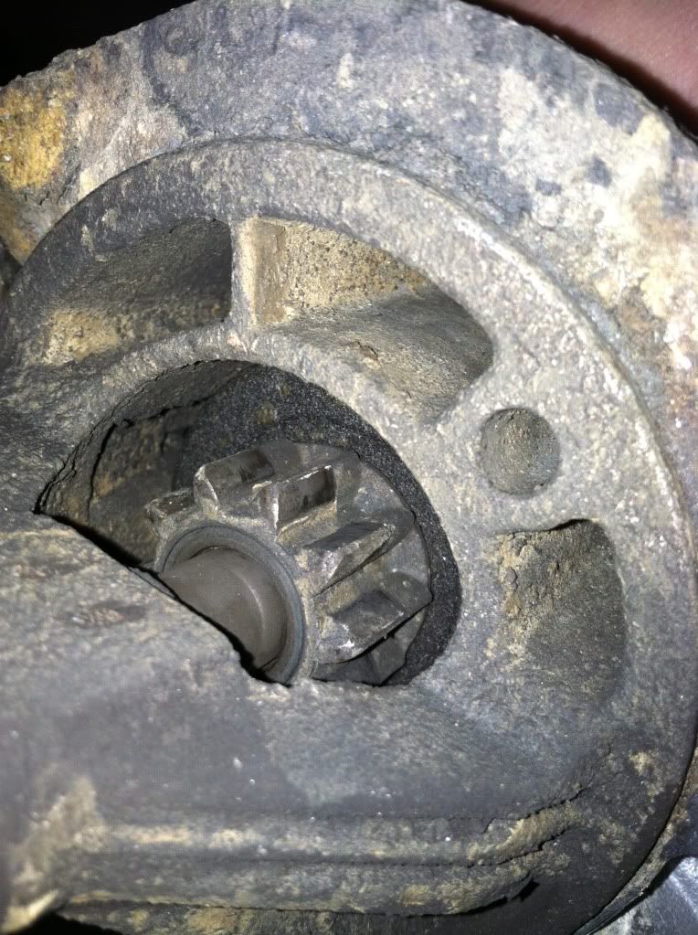

Ok, so it was 15mm and it was tricky due to wires having a mount there.. I did get it and it doesn't seem dirty, and the teeth don't look that bad.. I'll post some pictures ASAP.. I'm going to get it tested tomorrow and I'm about to look at the flywheel now..

it appears as though the starter gear is not fully engaging the flywheel from what I could see.. any ideas??

It probably just wasn't pushing out as far as it should. Just replace the starter and your should be fine.

Yep, easiest fix is to just replace it...
Before you have to replace the flywheel.

So I got it tested and they said it was fine, but I wasn't convinced with their method.. So I just got a new one and I will be rotating the flywheel tomorrow just to double check..

Ok, now to explain why I did not trust their method.. All they did was wire it up and crank it, so if the gear was not engaging the flywheel completely then there would be no way of knowing.. They should reformat their testing equipment with a flywheel and adjustable load(6 cyl is harder to crank than 4, etc.) because I am 98% sure that that was my problem..
It was shiny about halfway across the flywheel's teeth.. So to sum everything up, my starter was going bad, installed "new" one an now my rig starts up like a champ, no more grinding..

Bench testing a starter usually just means supplying voltage to it, and seeing if the bendix moves out and it spins. If the bendix is bad it won't show up in that sort of testing.
The bendix has a clutch mechanism in it. It allows the starter to apply torque to the engine to crank it so it will start. Once the engine starts it spins faster than the starter motor can, and the clutch releases allowing the starter gear to spin faster than the starter motor. That allows the bendix to release from the ring gear when the key is turned back from the start position.
I replaced my bendix recently due to a worsening start problem. My starter would sound rough and when the starter disengaged it did so with a clunk and you could feel the Jeep shift as what torque had been applied to the engine was removed. I had plenty of wear left in the brushes and the solenoid tested fine, but I replaced them anyway, and cleaned the starter up inside and out. Refurbing the starter myself cost about 30 ~$50. That's cheaper than I can get a used starter of unknown condition and way cheaper than a commercially refurbished or new starter over here.
