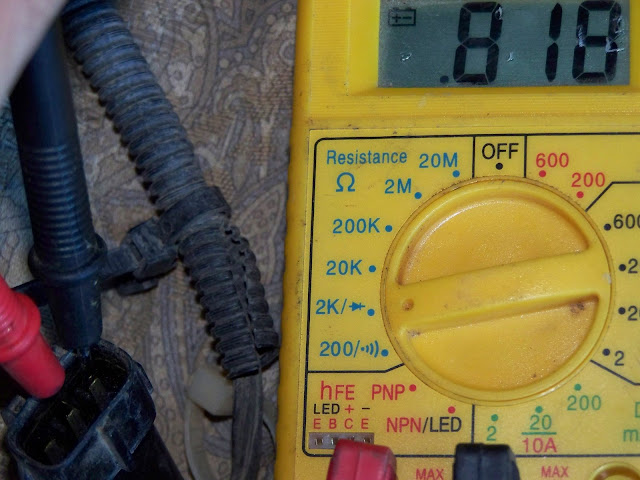

This is the tester and the test being performed on the CPK, don't know if the tester is set right, any help would be great. Also how do you test the ASD, and where is it? Also how do you test the coil, this is my daily driver and not alot of $$ available.
Went and got a new CPK and tested the same as the old, did not start the Jeep.
THANKS

Interesting it didn't show open circuit but is still good. Crank sensor test was directly quoted from the factory service manual. I did say that cam and crank sensors should be good as you were getting spark.
