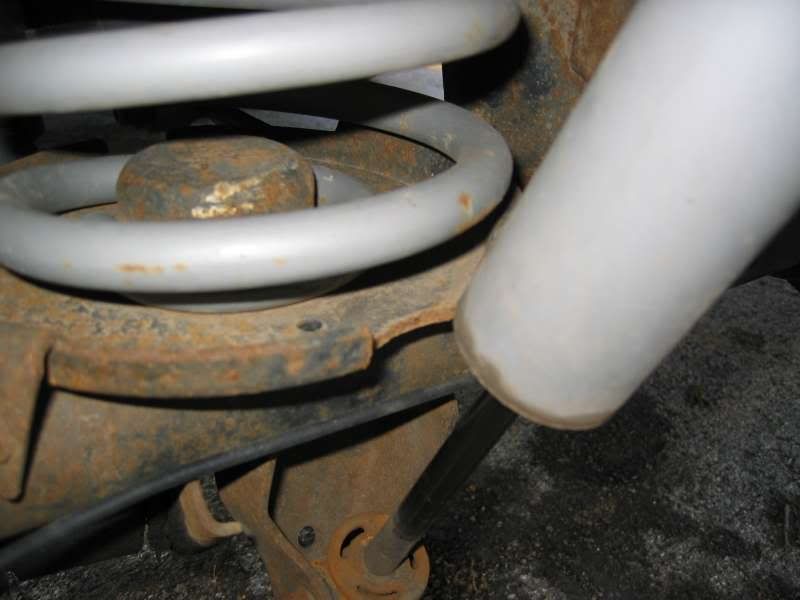

Guys, as far as I know the only way RE monotubes can be run is can-up as shown in both Jerry's pic and the pic of the JKS shock extensions. It also happens to be exactly how I've got mine setup . I will post pics of the issue tomorrow when I've got some daylight (and fresh batteries).
Hard to tell from this pic, but from the scrapes on the shock body it appears that the bottom of the shock makes contact with the spring perch. There are scrapes (off the top of my head) 1/4" wide but running maybe 4" vertically up the can on each of them:
thejafe is offline

post #11 of 18 Old 04-18-2010, 07:01 PM Thread Starter
thejafe
thejafe's Avatar
Join Date: Oct 2003
Location: Westchester, NY
Posts: 5,594
Ok, here is a (crappy) pic:

You can notch the bad side of the spring perch just fine.

Hell you can cut off damn near the whole back half of the perch without affecting ANYTHING at all, but giving more shock clearance.
And OP, you need more bump stop, you bottomed out the shocks to get scrapes that far down the tube. THAT is what caused the shock to leak.
