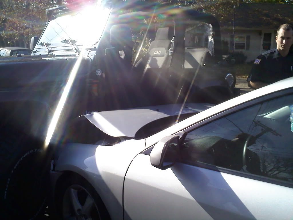

yea. it actually did happen the day the tires were put on.. i also got in a car accident not to long ago it could of loosened some things up and made it worse?

after the accident my steering wheel was turned to the left and stayed that way. its fixed now but u think it could be somethin to do with that?
