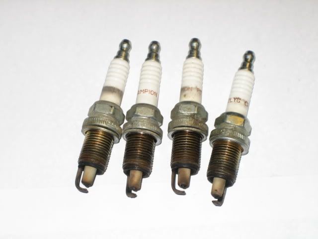

Got my Jeep in November, at 75 k I believe it still had the original plugs in it, Champion 2412.
I February I finally got around to pulling them gap was over 0.06.
I had read that Champions or Autolite AP were the way to go but they didn't have them locally. Decided to try the Bosch Platinum 4's.
I installed them and noticed that I had power back in the low rpm range. Great, the guys on the forum are wrong They were in for 6 weeks and about 1000 miles, noticed that idle wasn't quite right and it took a bit longer to start up. Pulled the plugs and found massive Carbon build up.
Needless to say I have ordered the Autolite AP's from Napa.
Next time I Listen
Jeff

Originally Posted by Pillswoj View Post
Got my Jeep in November, at 75 k I believe it still had the original plugs in it, Champion 2412. .... They were in for 6 weeks and about 1000 miles, noticed that idle wasn't quite right and it took a bit longer to start up. Pulled the plugs and found massive Carbon build up. ....
They look like the engine is running really rich .. maybe you have other issues.
Yeh it looks like it, however the Champions I took out were as one would suspect, a light tan deposit but generally clean, I will check the New plugs after a month to see how they do.
