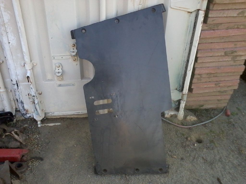

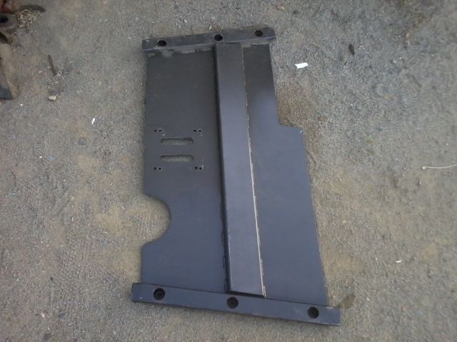

I'm working on my tummy tuck and will purchase a skid from friend pretty soon except he forgot the name of the skid. Here's a pic I was wondering if anyone could help identify it, didnt wanna start a thread just for this so I thought this would be the appropriate thread to do so. Thanks

It looks homemade.
33 Engineering. Pretty sure they're out of business now.
Yeah he said the manufacture was out of buisness. I thought it was 33 engineering but I wasn't sure.
