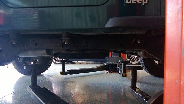

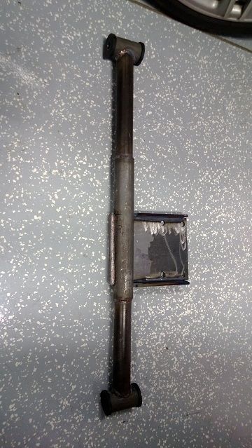

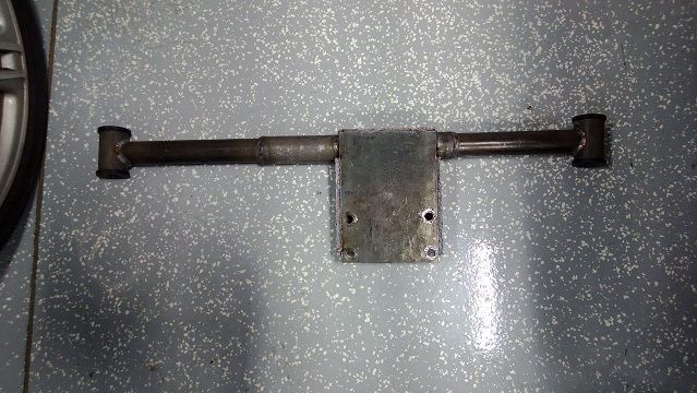

Finally got to doing mine, bought all the materials last summer but then I was traveling for work constantly and moving at the same time. Decided it needed to get done so got to it today. I still need to make a new skid, have a piece of aluminum I picked up last summer just need to drill and get it in place. Also need to paint it and rebuild the exhaust which I wanted to anyway. Unfortunately on the test drive I pulled the front shaft a part, apparently it is no longer long enough so I need to sort that out. When I did my super short SYE late last summer I built the shaft based on the tuck (know I would have no time to take it off road) so that is now perfect length.
I forgot to take pics of it in place once it was all done, phones out in the shop and I need to get home to walk the pups so I'll post up those later.
