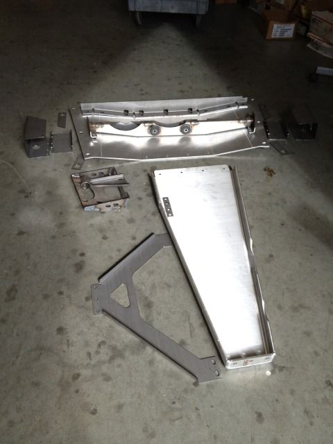

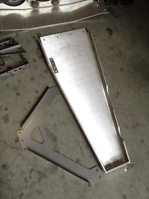

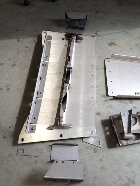

So many of you have asked for a modular Under Armor kit so the entry point would be a lot less. Well, here it is. These are spy photos. No pricing or availability yet, should be 3-4 weeks before I can get pricing but it will be very competitive. SO DON'T ASK YET!
We will now be selling them by kits.
1. Transmission Cross Member - Allows Jeep to be driven with the skids off
2. Aluminum Transfer Case Center Skid with steel cross brace
3. Transmission and Engine aluminum Skid with steel front brace
