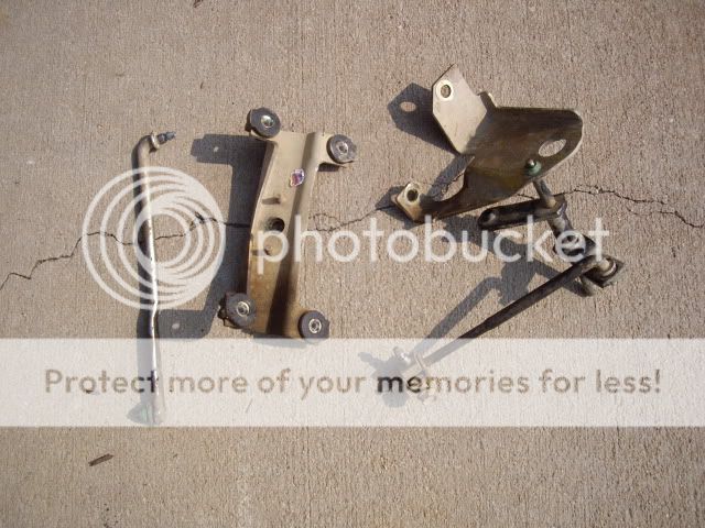

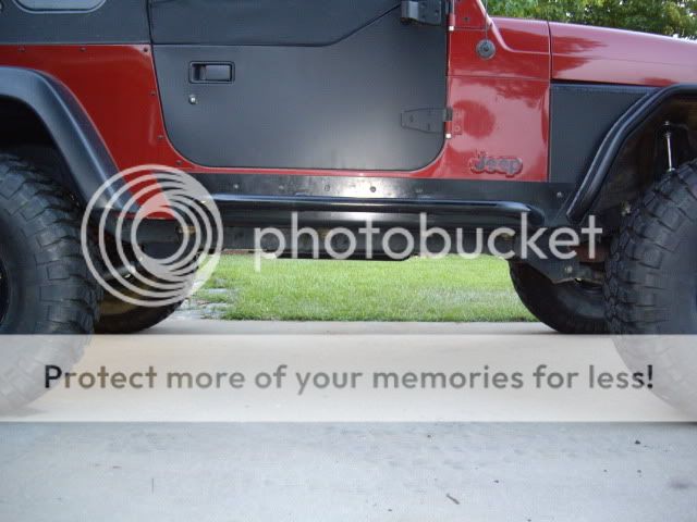

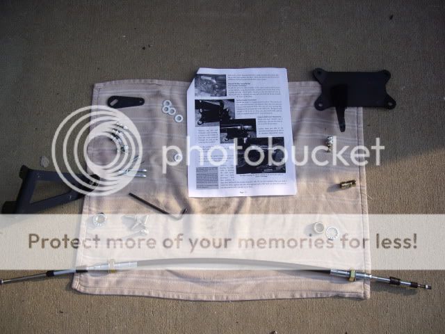

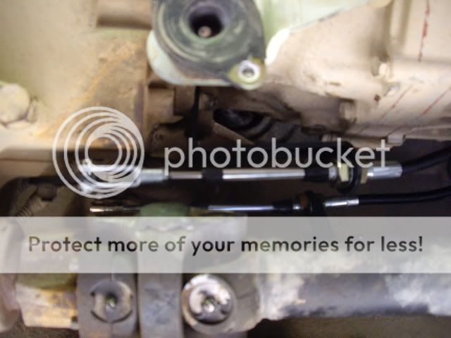

I recently installed the AEV TT on my 1999 4.0, AX-15 5spd, 231 w/SYE, no body lift TJ. First, The AEV TT for my application was worth every penny. By following the detailed instructions it installed without any issues. It was a substantial improvement in ground clearance and "works" as advertised. I ran it in the "As-is" configuration on a 1K mile round trip through Black Mt OHV, Gold Mt OHV, and Windrock OHV with out any issue. I did make one slight adjustment post trip, the transmission shifter when shifting agressively into 1, 3, and 5 would sometimes make slight contact with the dash/switch panel. I simply pulled the shifter out and used a press to increase the bend to provide more clearance. Lastly, I mention this next item because I know there are some of you that are or will have T-case shift linkage issue with other manufacturer TT installs, this was not required with the AEV TT as long as you follow the instructions. I upgraded shortly after the trip to the Novak cable shifter purely for the sake of upgrade, READ: I did not NEED to do this because of the TT install. The Novak cable shifter is again worth every penny (half the price of AA's cable shifter) and installed with instructions flawlessly. The T-case shifts smoothly and easily no matter how twisted and flexed the TJ may be. I highly reccomend (who the hell am I) the Novak cable shifter for any TJ with crappy worn out T-case shifter linkage.
AEV TT installed
OUt with the old
The new
Novak cable shifter installed
