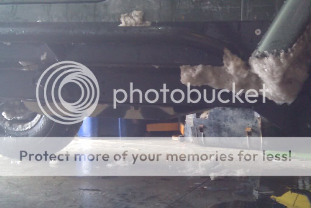

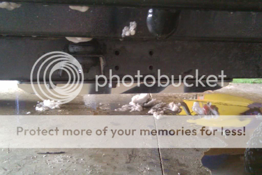

Originally Posted by BlackBellamy View Post
I just installed the 3/16" UCF skid two weeks ago. Went offroad twice and noticed the improved clearance right away. I don't drop onto rocks on a regular basis so the thinner plate works for me.
I have a 1.25" BL, MML, SYE and had no clearance issues with the exhaust or anything and the fitment was good. I was able to mate my older design Skid Row skid to it after grinding away a corner of the engine skid.
The welds were ugly but sufficient and there was spatter but it's a budget entry into the field and what I expected. If someone stole it, I would buy the exact same one.
Originally Posted by rubidriver View Post
Do you have any pictures of this skid on or off the Jeep? Also, what all else did you have to purchase to make this work? Tranny mount? Hardware?
I have the same setup (except my skid is the 1/4" version) and overall experience that Black Bellamy has had with the Undercover Fab skid: 1.25" BL, 1" MML, SYE and double cardan drive shaft with Currie adjustable rear upper arms. None of the exhaust or anything had to be changed, we just put in the SYE and what not and bolted the skid right up with no clearance issues. The hardware you do have to provide but you use the stock tranny mount so its just the six frame bolts, and I'm just using the stock ones for the time being. Here are some pics of it mine, my friend had a little fun with the spray paint haha.

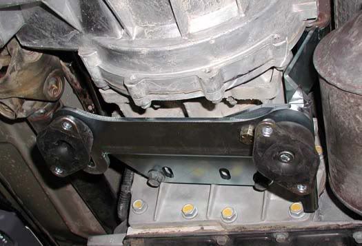

I have heard of people using different skid plates, such as Rockmen and skyjacker, with the AEV trans mount to avoid a body lift. Any comments on that? AEV Jim on their forum stated they could be sold separately for around $100. Below are pictures.
