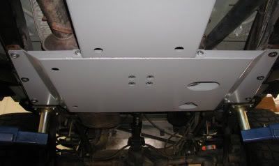

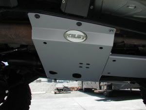

Kilby

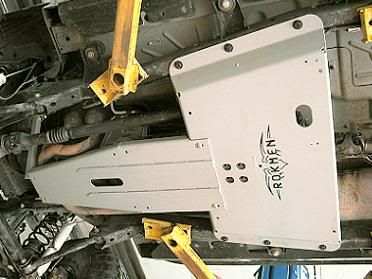

Rokmen

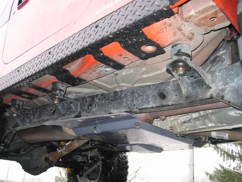

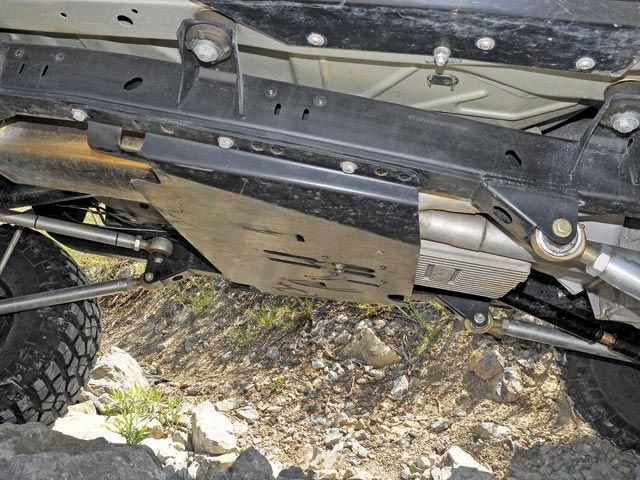

Teraflex
Under Cover Fabworks

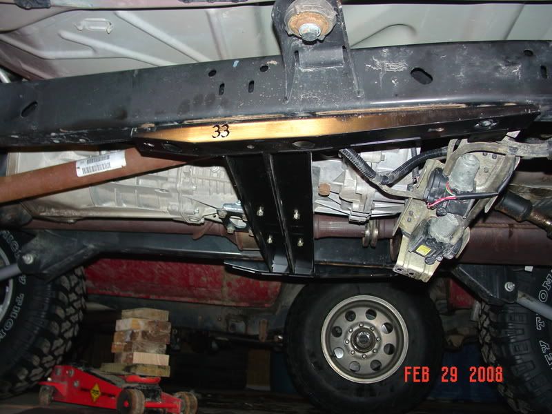

33 Engineering
Jeepmedic

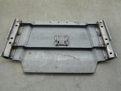

Savvy

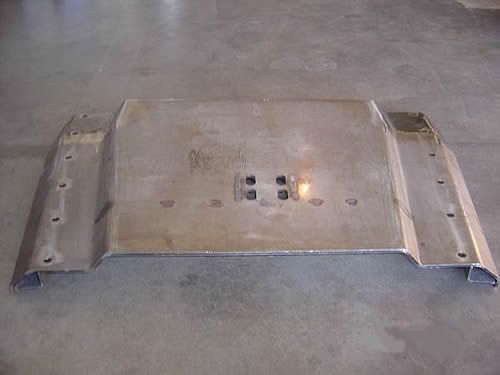

This is what I picture the Savvy skid to look like for the TJ. This is the one they made for "ErikJordan"'s YJ. Im sure it will similar. This should be fun to see.
