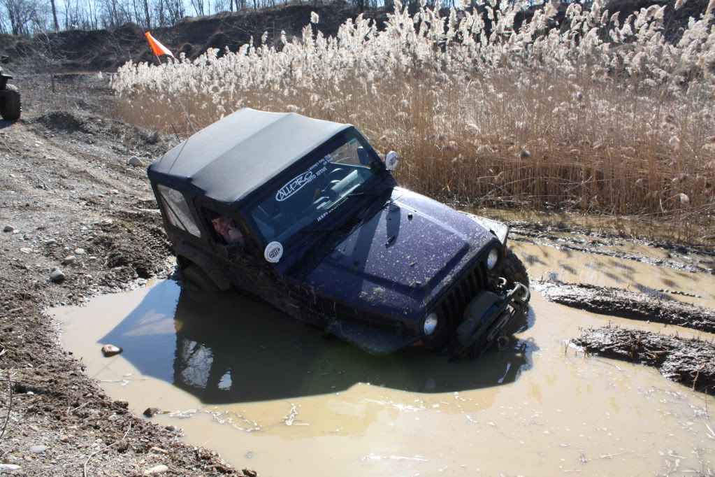

post #7 of 10 Old 04-28-2013, 03:34 AM
PurpleTJ
Location: Okemos
Posts: 1,815
Originally Posted by McLovin View Post
Or what about when the water fills up your exhaust system?
Just don't turn it off. I don't know how it will do in deep water, but I got stuck in a good muddy puddle up above my exhaust. I left it running and the exhaust kept bubbling out. Might be a different situation under deeper water.
I thought I had a pic from behind, showing my pipe. Guess not.
Purple Jeep Club member #8
PurpleTJ is offline
