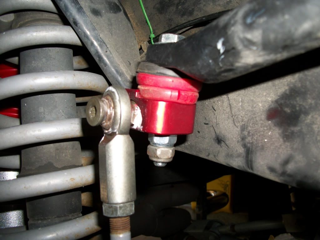

For a softer ride adjust air pressure using the weight to psi method. Use this type of swaybar link then place your sway bar in a horizontal position and using a a few shock bushings attach like this:
[IMG][/IMG]
Adjust the tightness to suit your ride.
