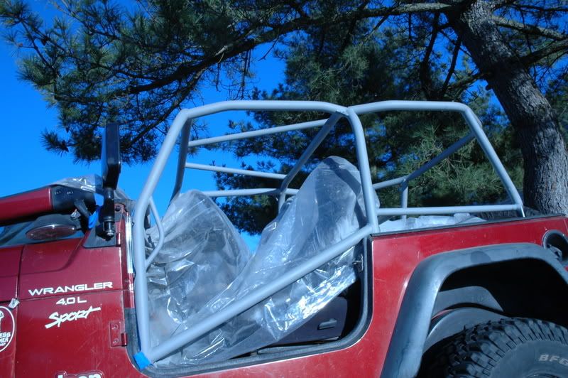

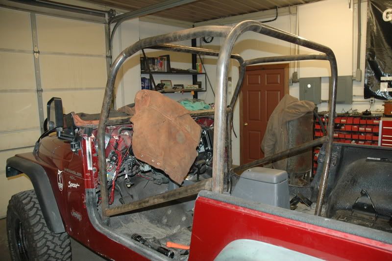

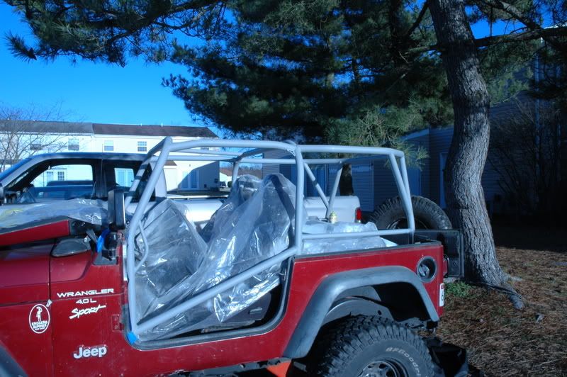

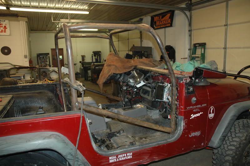

Recently build a new cage. Still got some work left to do after I figure out seats and other crap...

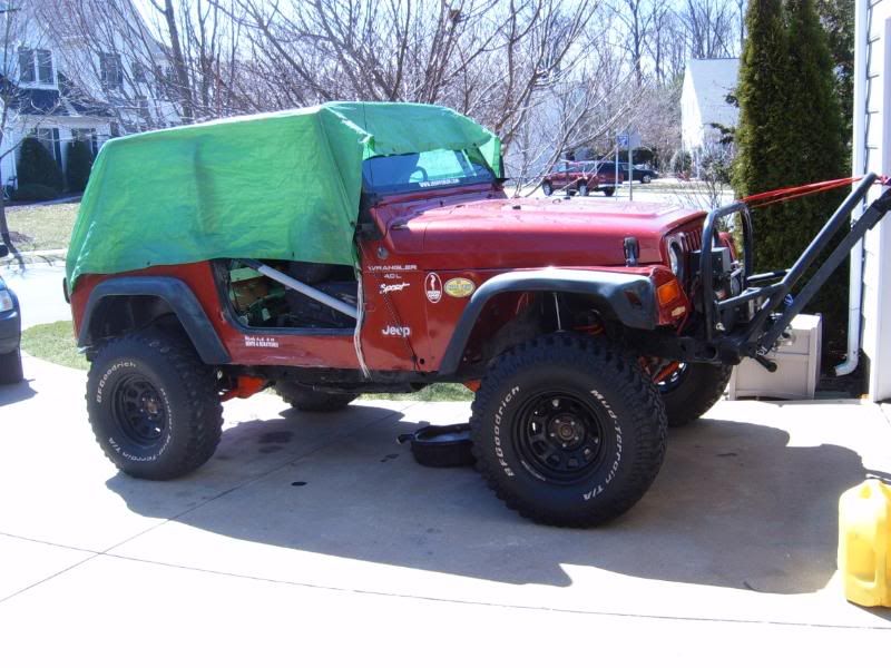

Now catching up with the up to date stuff...
Here is how she sits as of two weeks ago:

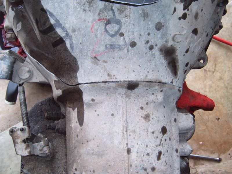

Cracked my tranmission housing so I am in the middle swapping then around.
I also ordered a teralow 4:1 kit. Going to add the to the TC as well as a SYE and 2 low kit.
Should be done getting the tranmission internals swapped over to a new housing by the end of the week. And hoping to get the trans back in the weekend of the 12th.

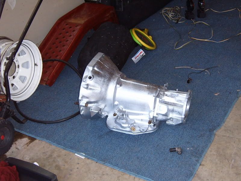

New trans ready to go in...
Giving it a whole new meaning to shiny side up!
I moved the breather on this one too, so i will get some pictures with the new location shortly. Got a new trans cooler. Going to pickup my new trans temp gauge today and I will be set to get it in this weekend.

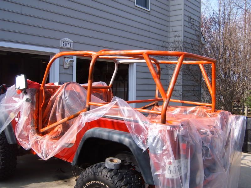

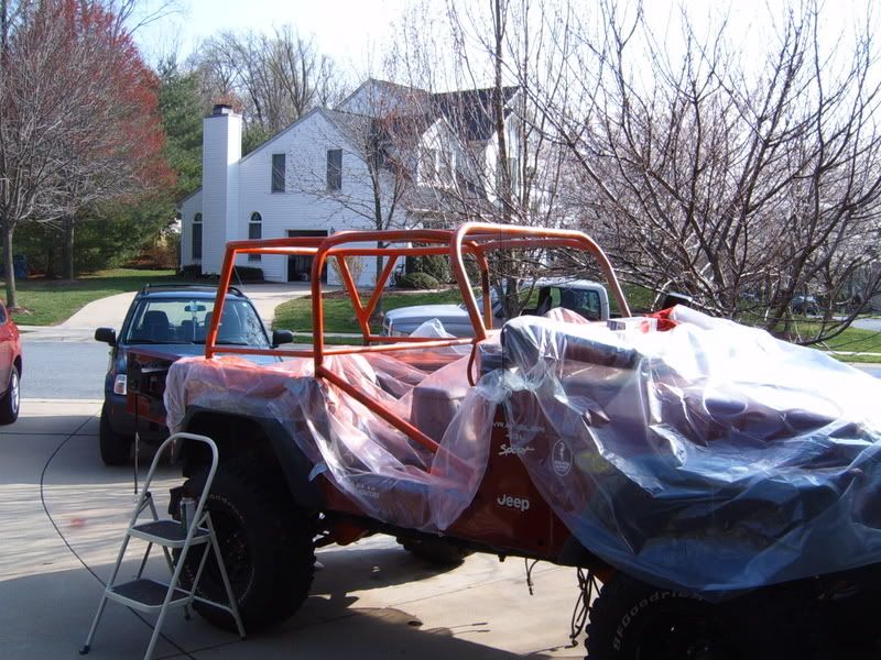

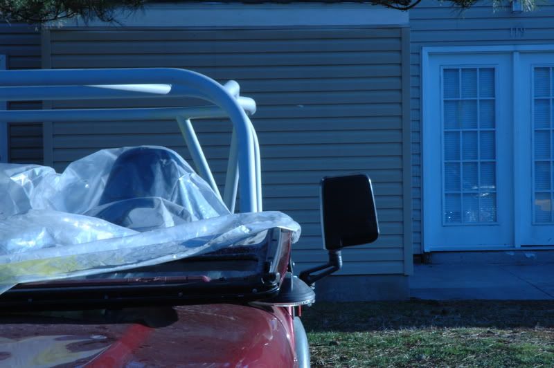

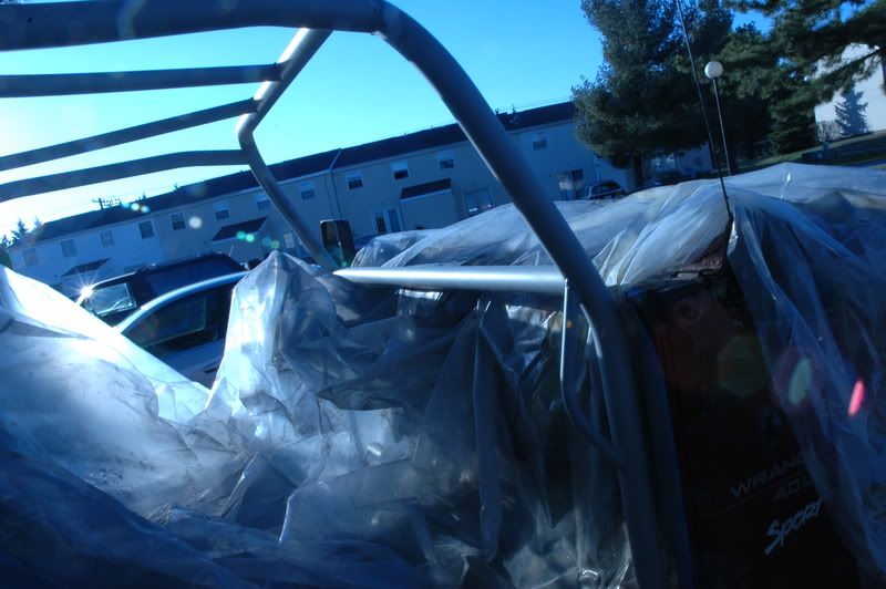

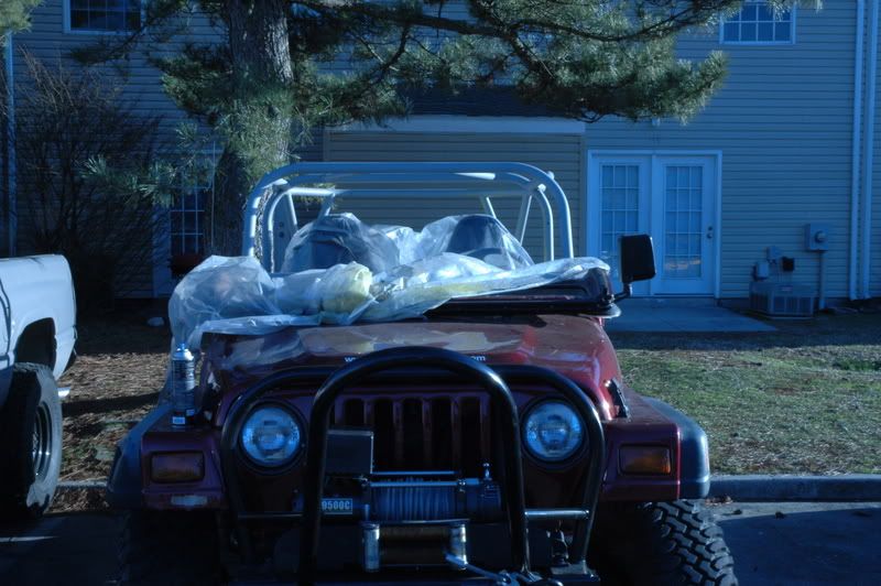

got started on painting the cage since I have nice weather...
Better shot of the BLING

thanks, and yeah I still have a few more coats to apply. Just got bored waiting for it to dry so I snapped some pictures.

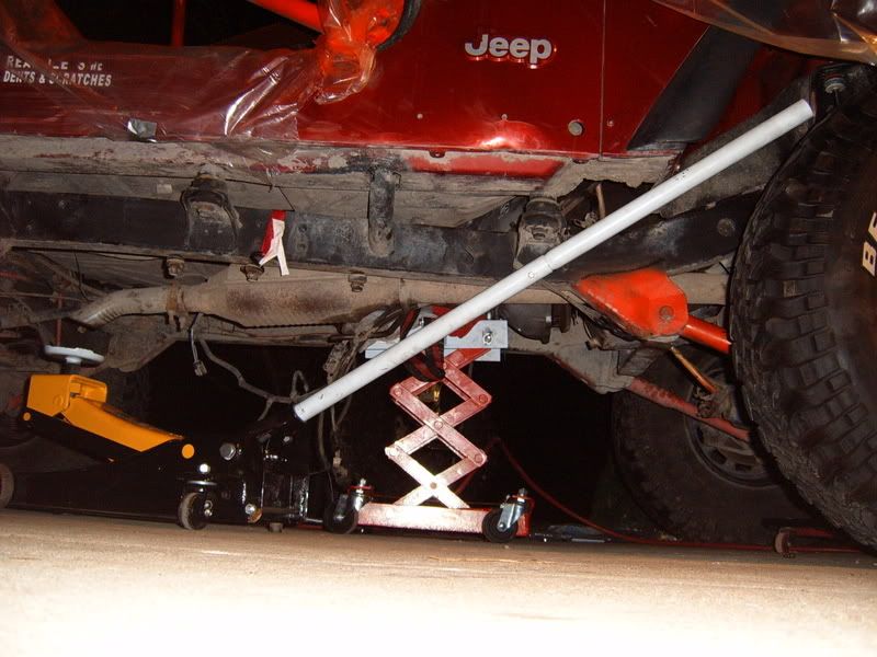

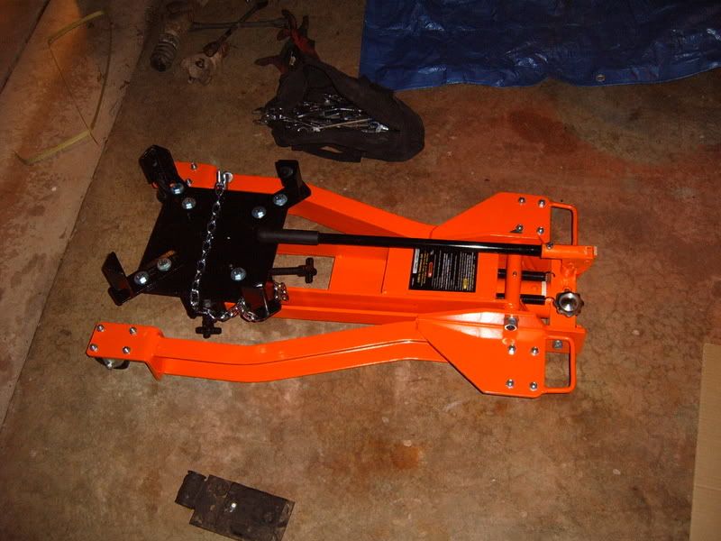

Oh another note, I had a ****ty HF trans jack that sucks for adjustment and I can not get the trans lined up at all! Looks like I am heading out to get me a new jack
I got away with 2 regular jacks, but it still sucked. Make sure the converter is fully seated, I thought mine was, so attempted to put the trans back in. I ended wasting 6 hours trying to get the dowel pins lined up, but it just wouldn't line up. I brought the trans back down, seated the converter again, and it lined up with little effort.

Painting cage red I hope? LOL! Nice build so far. Interested to see how it looks when it's all put back together.
Nope, seems mferrari has a thing for orange spray paint.
And how did you manage to crack the transmission housing?

haha yes it is ORANGE!! But orange tractor paint (holds up better).
I cracked the housing when my driveshaft broke. I guess the torque from that sent the trans sideways...
A note to everyone. The HF jack that uses an impact gun sucks to installing a trans!! It worked great to take it out, but it does not have enough adjustment to install a trans (for a single person job).
Bad:
For $200 this one better do amazing!
