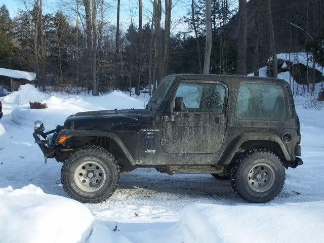

I have it on my sport now and I like it but I wish I went with at least a 3" sl without the spacers live and learn I guess. That kit comes with bump stump extentions too.
If you can wait a couple of months (which I know you can't) you pay shipping and I'll give the spacers when I redo my lift with longer coils
here's a pic of my running 32's

What didn't you like about the lift? Did you want to go bigger, or is it a crappy ride?
Thanks for the reply, looks good in photo.
