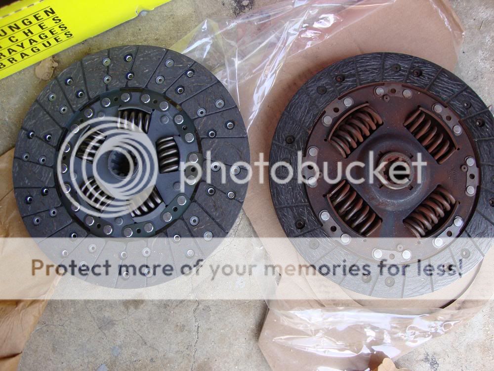

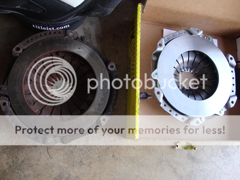

What about the difference in the different brand clutch kits? The one I took out of my Jeep was a Sachs and had a larger center with less surface area on the pressure plate and friction disc, but the Luk I installed was different.
Maybe the Sachs I took out is for a flywheel that hasn't been turned flat and the Luk is for a resurfaced flywheel.
Luk on the left, Sachs on the right.
The Sachs pressure plate on the left
Why would the Luk be different?
Not relevant anymore because newer Sachs clutches have the same amount of friction material (possibly even a tad more) as the Luk.
This is the Sachs clutch I installed in my Jeep 3 years ago.
