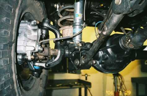

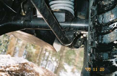

I silica blast my axles and use acid etch primer, then use Hammerite paint. Holds up much better than rustoleum. Works for me...
