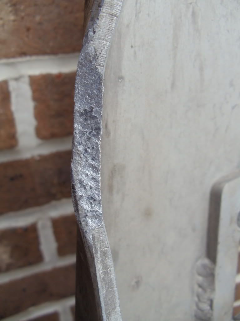

Couple things I noticed when pulling the old one off. First, looks like I had contact with the exhaust when it was nice and hot:
There was actually a silver line of aluminum melted onto the exhaust. Knew it was close, but didn't realize this was happening. Tried to get the new one positioned with a little more clearance.

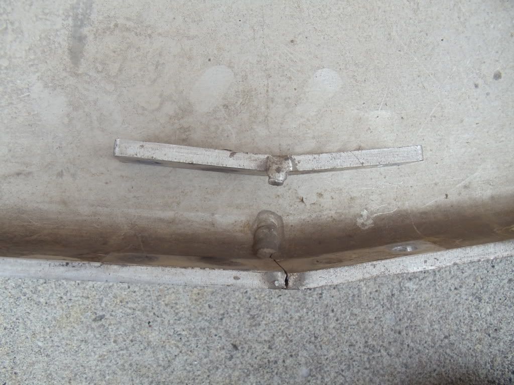

Second, it appears I had another broken weld also on one of the internal braces in the side bends. This particular one has a bolt through it also that was holding it on but as soon as the bolt came off it fell right out:

I have tried to get the fab shop to take that reinforcement piece for those two joints, turn them into steel and then through bolt them instead of the welds. Perhaps when they see this skid, they will listen.
I just checked mine and the reinforcement plates have welds on the end verticals.
That's only a mildly better solution due to the welding really dropping the strength of the T-6 Temper to something much less strong.
I just installed the 97-02 belly skid and we had the same issues and it wasn't that the skid was too high, it's that the exhaust would not stay put even when we loosened and tightened the bolts at the exhaust manifolds.
Right above the skid where the exhaust crosses it is a bolt boss in the side of the engine block that is threaded for a 3/8-16 coarse thread. I took an exhaust hanger that uses the u-bolt around the tube like this one.
Put the exhaust where it's supposed to be and bolted the hanger to the side of the block. It will never sag again.
