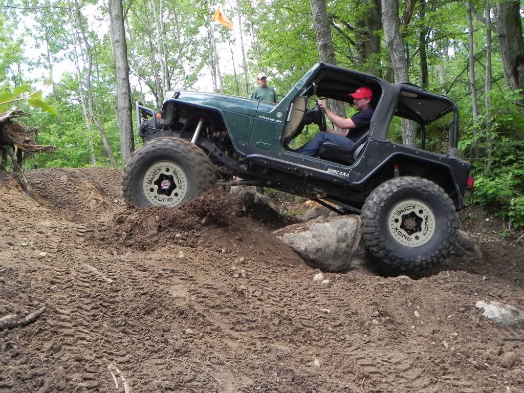

With the rear wheel well trimmed back and the tire not hitting anything on full stuff with a stretch a little extra opening looks fine. That is how most people I have seen do it (running stock TJ sliders). Here is my buddy's TJ on 39 inch krawlers stretched using stock TJ sliders. Not much was trimmed from the front of the wheel well.

Here's Mike's TJ. I believe he only trimmed a little in the front. The longest point of the steel sliders is 57-3/8". The aluminum base is longer and can easily be trimmed.
