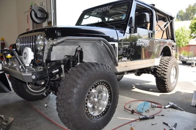

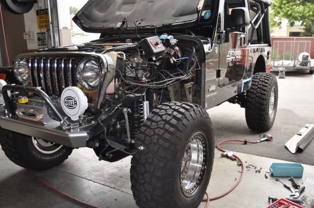

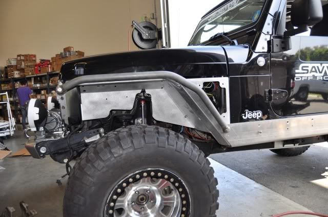

Disassembled the front to test fit the Metalcloak Overlines today. Monday everything goes to the Powder coater!
They came out nice! Only minor modifications to our rocker bases are required.

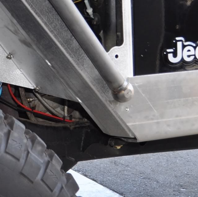

I'd really like to see a close up on the rocker mod since I'm going the same route. Looking good so far.

I zoomed in on the above picture. Basically you just need to rip about 4" off the front of the aluminum rocker then notch around the ball. One our mounting bolt holes ties the fender to the rocker nicely
