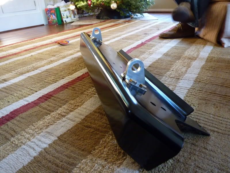

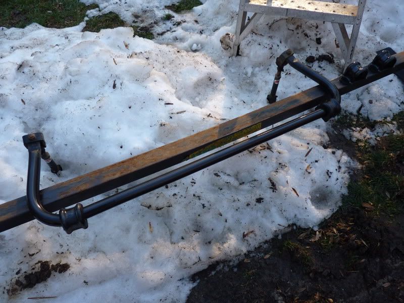

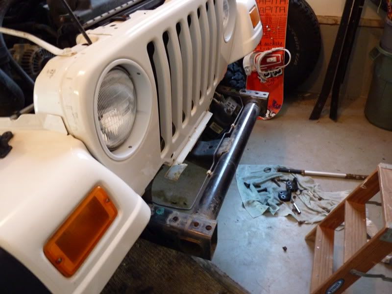

Okay and this is where I am right now:
Got the front of my jeep taken apart: Bumper, sway bar cover, sway bar, steering box skid.
Sway bar and pieces got a quick coat of hammered black to keep them pretty.

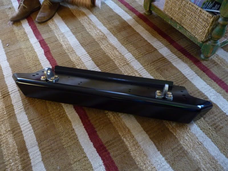

Brought the bumper inside out of the cold. Paint is dry to the touch, but still can be scraped with a finger nail. Put the recovery tabs on finger tight and this is how it's looking:
Paint came out nicely. I'm curious to see how the Rokmen steering skid will mate up with the Savvy bumper. Also need to do my front license plate.

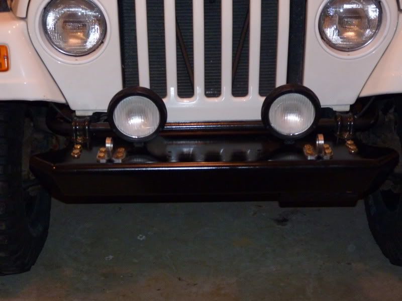

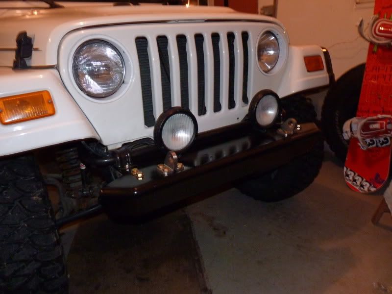

Alright I'm finally done. Took some finesse to get each bolt in the right way, but I managed. I had the bumper completely on, and than I went to put the sway bar back on and it wouldn't go over the lights . Since the lights are in the fairleading mounting holes, you can only get to them by taking the bumper off. So I had to take the bumper off and slide the sway bar on that way. The steering box skid bolts were also a little tricky egtting them lined up. There was a lot of put the bolt in, take it out ,put it in, try it again type of stuff but it was a very straight forward install. Than now that everything is in and fits, I realize that one bolt on one of the recovery tabs is not tightened all the way ! Oh well, not taking the entire thing off again, I'm not going to worry about it.
It's dark out here so the pictures didn't turn out too well. I'll get some more tomorrow in the light.
