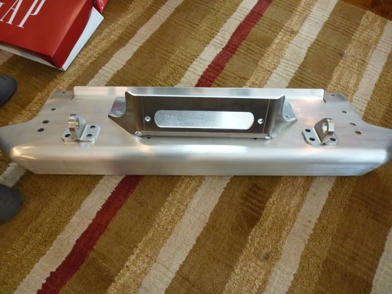

I posted this in the other thread, but the Hanson Bumper that I removed was right @ 77lbs (with Winch mount/Foglights/D-rings), and the Savvy is a smidge under 20lbs and I expect not much more than 25 with Foglights/D-Ring, etc.
So I essentially "lost" 50-55lbs up front once all is said and done from the swap.
I've seen a few guys in this thread and others, mention the smaller bumper not being real "Deer" friendly, and I don't disagree...luckily I don't see much deer where I wheel in NorCal, nor do I daily drive (maybe 50% DD), nor do I do much night wheeling, so plowing deer was never really a consideration.
ALSO, I don't live in the Rust Belt, I see snow/ice exactly 1 weekend a year, no salt, so rust and corrosion is not really an issue. I left my Savvy Gas Tank Skid Bare and like someone else mentioned, if this starts to look bad, I'll pop it off, hit it with some primer and paint and call it a day. Gerald suggested a Matte Clear Coat, but I didn't find it today, so I'm going to leave as is it see how it goes.
This bumper isn't for everyone visually or functionally depending on where you live and where you wheel... For what I do, and where I go, and where I want to go, it "fits" me perfectly!

just wanted to make sure I understand, you went from a bumper that gave full protection to what amounts to a shelf for a winch?
'03 TJ Sport,Light Tan Metallic,, Superlift 4" with BFG 33x12.5x15
Honk if you love Jesus...text while driving if you want to meet him!
hoosier724 is offline
post #42 of 272 Old 12-24-2009, 02:10 AM
Goobersbro
2007
Location: Yuba City, California
Posts: 4,138
I did yes but I am making tube fenders. I don't need the full width protection the tubing should take care of itself
The OP also did but he really doesn't need the protection of a full width bumper. He explained this in his above post

That much weight savings (while maintaining quality & effective strength) from a lone component is worth the $$$.
I do which is another specific reason I like aluminum. Sure it'll still corrode, fade, etc. over time. But, it should be much easier to maintain. You should see some of the vehicles up here that are 5-7 years old with completely rusted-through swiss cheese body panels. Nasty...
