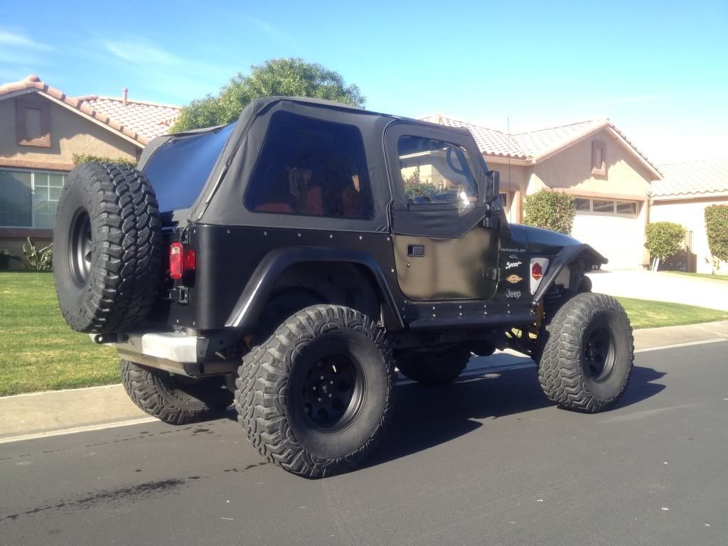

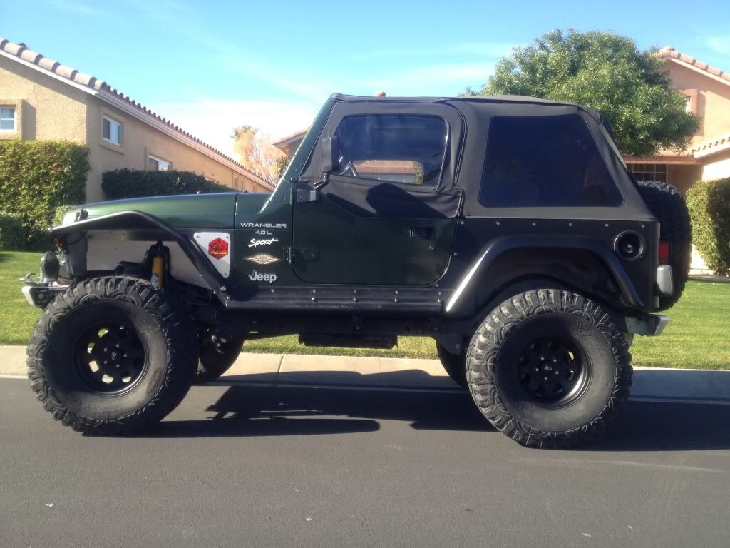

Installed a while ago, but decided to paint. Thought worthy of a new post.
[IMG][/IMG]
[IMG][/IMG]
