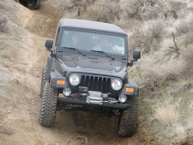

I used Roadmaster XL removeable brackets and a cheapo Roadmaster tracker towbar. A fellow Jeeper gave me the frame mounts because they came with his Jeep and he did not need them. Cheapy magnetic towlights I stick on top of the rear bumper. I do not like how the towbar mount part that stays on the Jeep hangs down below the front bumper. But, I do not have to have a very large riser to keep the towbar level. First click forward on the ign. switch, TC in nuetral, tranny in park or 5th gear. You are good to go.
