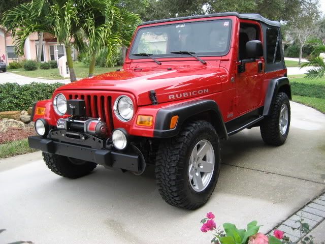

Its pretty obvious to see. Take a look at the difference here between a stock to a modified:
slightly modified:
2003 Jeep Wrangler Sport: Current Jeep
2006 Jeep Wrangler Unlimited: (Sold and missed!)
