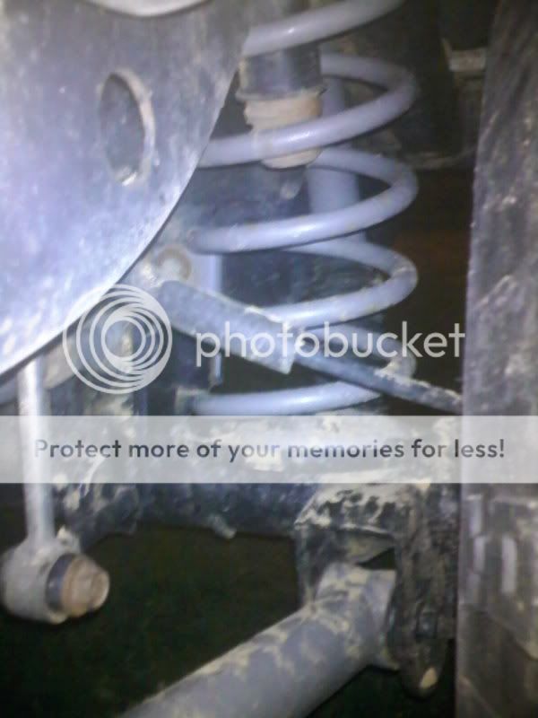

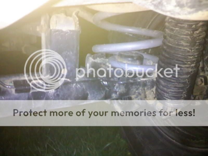

i have 98 sport that i am putting a rubicon tri-link long arm 5.5 on and i was wondering if someone that has one can tell me how the spring pads sit are they level or back and do i need the swaybar on the back or is it ok to run with out it on something you drive on the road like 200 miles a week. also can someone tell me how you are suppose to run the muffler so that it dont get in the way of the top links?

ok i will let you know but how does the spring pads sit on your axle the reason im asking is because i have an 8.8 that i put in it and i dont know if the pads are exactly right?

I have the tri link, great investment. I run the sway bar on the rear. i ran mine for a month without any sway bar at all on the front. Drives fine and is a DD. Muffleer guy, friend of mine, just kept it close to body as possible, no rubbing yet. I will post u a pic when i get home so you have an idea.

RubiconR6
Location: Greeneville
Posts: 167
[IMG][/IMG]
RubiconR6 is offline
post #10 of 31 Old 04-12-2009, 07:20 PM
RubiconR6
Posts: 167
[IMG][/IMG]
