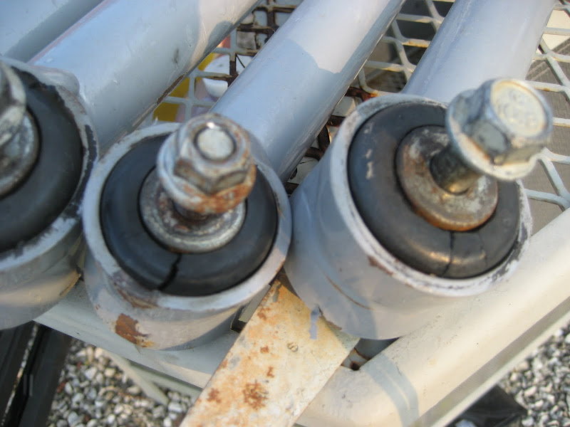

Search for RE Bushing and you'll find the major issue with using a RE kit. They go on nice and ride decent but the bushing design wears out quickly.

I didn't do enough research when I lifted my 06 Unlimited a few years ago with the RE 3.5" Superflex kit. I got tired of replacing the "new" bushings with "new and improved" bushings only to have them fail again and again. My answer is now to just save up for long arms...

One man's trash is another man's treasure. I had the RE SF SA kit and couldn't get rid of it fast enough. All that remains of it is my track bar and it is being replaced. I don't know if, it is the type of wheeling or lack of wheeling or what but, I got tired of replacing the bushings too. I am quite happy with my Currie SA CAs, w/JJs on both ends, and replacing the bushings on the axle end of the upper CAs with JJs made all the difference in the world in driving on the street.

The issue with the RE bushings was originally that they were produced overseas and not made as strong, now they are produced in the US and still seem to have the similar issue of being too soft it seems. My rear axle seems to have more axle wrap than it should.

No, the issue is that it was a bad bushing design from day one! RE's latest excuse was the overseas production.

One tip with the RE rubber bushings is to torque with the wheels on the ground at static ride height. If you torque them off the ground, there will be a "pre-load" on the bushing that will assist with early failure.

I have no complaints except that I now wish I had gone long arm. RE definitely had a problem with their bushings. The new bushings, out since may/june are a completely different compound. I even noticed the difference just looking at them.

My origional bushings blew out the first trip off-road. The "improved" bushings have survived the same offroad park including more difficult obstacles. I purchased adjustable control arms, so if they blow out again I will install SF joints at both ends of the arms.
