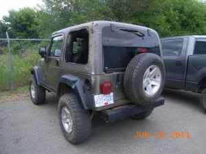

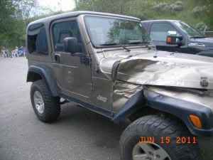

Heres a couple pic's

I would so snatch that up for $4500! It's hard to believe the insurance company totalled it out for a smashed hood/fender and a broken hard top window.... There has to be something else wrong with it like a ruptured T-case, bent axle housings, etc... That looks like a lot of damage for just a "flop" it looks like it rolled over at least once.

Thats been for sale since last summer, it looks worse in person.
Several of my buddies have looked at it and no one thinks its worth rebuilding, you can find good ones for 10 to 12 grand here, and sometimes less.
