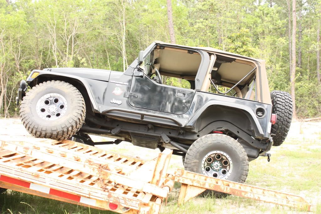

grab a jeep mag or jump on the internet.. the prices are pretty competive in either media. as far as the long arm kit is concerned.... long arms rock. they are definate upgrade in ride quality. your keeping the tera springs so that portion wont change, only how the jeep reacts to bumps in the road. the LA reduce the jaring and impact transfer. just makes it smoother ride. that RC kit looks like an ok way to get LAs under your rig. especially if its primary function is a DD.

I'll second what the giant panda said about keeping the tera springs. I don't have the long arm RC kit but I do have the 4" short arm lift from RC with the performance 2.2s. The RC springs took a while to break in and were rough for a while but are really nice now. I'd recommend just going with the long arm upgrade kit from RC and keep the springs and shocks if they aren't in bad shape.
