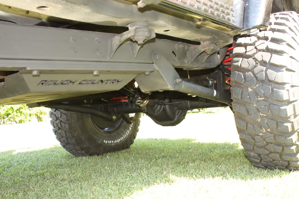

Here's some pics of my TJ after a wash

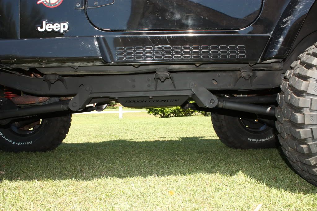

some more
