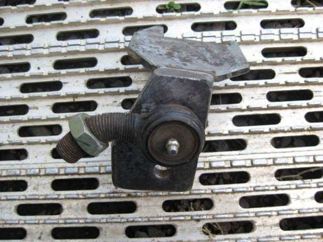

Hard Bushings and the 22mm TRE threads are Issues IMO, That is the same as the skimpy pitman arm TRE which Rusty's also uses.... that's skimpy compared to Currie and JKS.
if yer lucky, it'll bend instead of bust...
RC still hasn't sent me a Front Track Bar to Test MY Way either to put the matter to rest......

The bushings can cause and contribute to DW... that's why I'll never recomend or use one...
Send me yours, I'll put it on and take pics with the springs removed of the clearance issues, if you're lucky, I won't send it back to you bent!
How did you bend that may I ask??--and what's a TRE. Us new to the Jeep world don't understand your abreviated lingo.
A track bar does one simple thing. That's to prevent your axle from going side to side on you right? How in heck did you bend it? Severe wheeling?--Rock Crawling?

TRE = Tie-Rod End. lots of track bars use tie-rod ends, because the frame mount is tapered like the steering knuckle.
the track bar sees A LOT of stress...some people actually rip the mounts off the frame or the axle ends. its not just wheeling where it sees stress either, every time you corner...it keeps the axle centered under the vehicle under all conditions.
