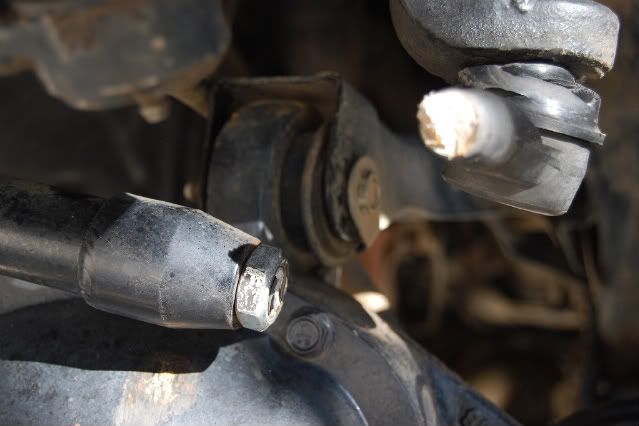

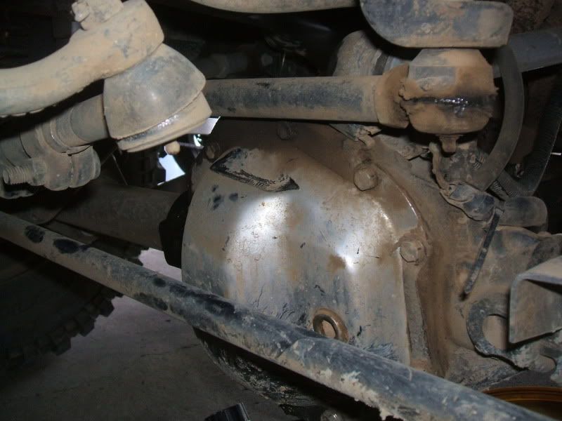

Here's 7571 whacking a diff cover pretty bad.
here's a similar bar that uses a frame side tie-rod end:
The best clearance track bar available right now is the Currie TJS or TJJ model. It requires 2" front bumpstop extension, which is the minimum bumpstop extension requirement you'll find with the stock diff cover, unless you change to a ZJ V8 tie-rod.
Read through this thread, in its entirety, it's all in there.
http://www.jeepforum.com/forum/f9/tj...it-fit-738948/

Unlimited that pic is of a 7571 trackbar. The 7572 has a diff bend and is 1.25 od.

sorry, my mistake.
While we're on the subject, how much bumpstop extension does the 7572 require?
Can you show pictures of that track bar at full bump, or at least at the bumpstop extension requirement, with the spring removed?
