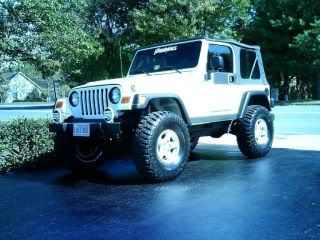

I've run and installed several RC series II lifts with the 2.2 shocks and have never had any problems or complaints.I always run 35's(eventually) and add a BL or 3/4" spacers up front.I always ditch the huge t case drop supplied and do a MML.On all of my installs I've only had to drop the t case 1/2" to get rid of all vibes.
RC 4" with 33's.
RC 4"/1" BL with 35's.
RC 4" with 3/4" front spacers and 1" BL with 35's.
