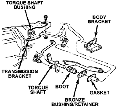

SHIFT LINKAGE ADJUSTMENT
Shift transfer case into 4L position. (make sure your shifter is fully in the 4L position)
Loosen lock bolt on adjusting trunnion
Be sure linkage rod slides freely in trunnion.
Clean rod and apply spray lube if necessary.
Verify that transfer case range lever is fully
engaged in 4L position. (you can do this under the vehicle at the transfer case)
