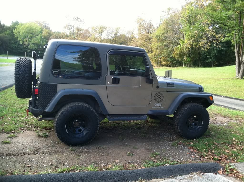

Originally Posted by Tannnner View Post
Anyone else have any side pictures of a TJ with 31s on flat ground?
Not the greatest but I can get more later
