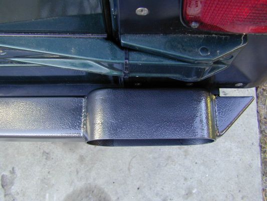

I am suprised people are concerned about how pretty the welds look. To me as long as they are functional that is all that matters. But to each his own. If I did not already own an ARB I would consider buying that bumper - I like the integraded light pods and overall design. I would still lean towards the ARB though.
Why would you be surprised? That is not a cheap bumper. If it were a 100 dollar throwaway built in some beginning weldor's garage, then they are perfectly acceptable. But, to stick that price tag on a product with that quality of welds staring you in the face, well that says volumes about the company.
If the owner says they look fine, he needs to be in another line of business. They are pathetic, thoroughly downgrade a product with a hefty price tag and clearly appear as though a beginner did them.
I wouldn't accept them on a 300 dollar bumper.

Wow... didn't expect it to be that big of a deal... I'll forward your comments to him but as I said, I don't see much need to be concerned. Yes, the pics you posted are nice Blaine, but I'm happy with the bumper as-is.
I see your point about demanding perfection at that price, but I dunno... as long as it doesn't fall apart I'm happy. You do have far more experience than me Blaine, if there's a reason the weld quality makes the bumper weaker I'd like to hear the explanation but if it's just a matter of looks, I can deal with it as-is

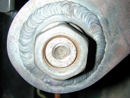

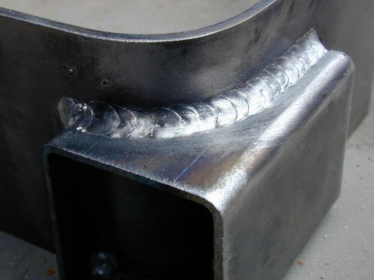

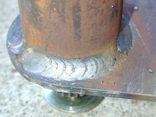

Those weld pics I put up were me teaching a friend how to weld. Those are his very first welds. The lumpy one is me telling him what to do, watching him, and then making a correction with the second being the result.
I am not asking you to demand perfection, just acceptable quality that looks like it was done by a professional.
For the money you paid, they can afford to hire guys that weld like my buddy.
If I paid that much for it, all the welds would look like the one above.
It's not whether or not the welds will break or the bumper is weak. It's an indication that the weldor is not experienced and lacks skill.
A weldor will not only turn out strong welds, but his skill at what he does will also cause him to make welds that not only appear good, but are good.
Rule of thumb is that any weld that looks good, is good, because it takes a bit of skill to make their appearance look like someone who knew what they were doing.
The inverse is also true. If your welds look like a kid in his garage is subbing out work from RA, that's probably the case.
Look at this guys work on a diff cover. Mind you, it's a diff cover and it has to survive the rocks.
http://www.pirate4x4.com/forum/showthread.php?t=317087

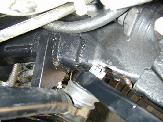

Location: Quail Valley, California
Posts: 22,657
Originally Posted by urbanassault
Those are some damn pretty welds someone is doing
With the exception of the learner ones I posted above and the pitman arm that my buddy tig welded for me, all the rest of the welds and fabrication are mine.

Thank you mr blaine for backing me up. The welds I do at work are all xrayed. As for explaining how a crappy weld is crappy? It's self explanitory. If it looks like shyt, chances are that it is shyt. (on the flip side, you can have a great looking weld, and it's all on the surface.)
Anyway, the welds done at my job are all x-rayed. They have to be able to take the pressure of 1005F superheated steam, at 3000+ PSI for 15 - 30 years before the boiler tubes are replaced. If any of the welds looked like that, they'd laugh at it like it was a joke.
Anyway, while the bumper won't have that kind of strain on it, it should still be able to take an impact.
Mrblaine, that diff skid is pure sex. To get heat distortion on the sides like that, of 3/8" plate, he got some serious penetration.
