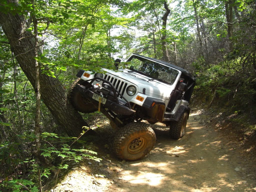

And some more...

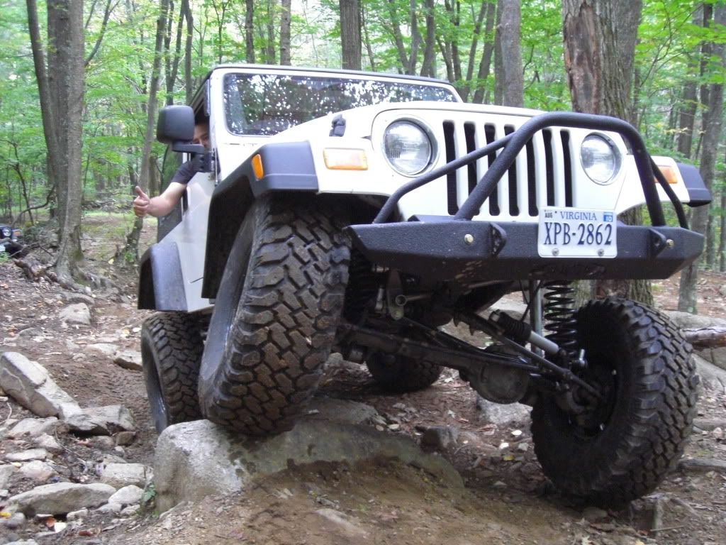

Those were all with my home made axle side sway bar bracket (I never got around to installing the driver's side bracket). Here are some of the inner C mounted sway bar brackets I got from Mr. Blaine. They fit perfectly and almost lined them selves up.

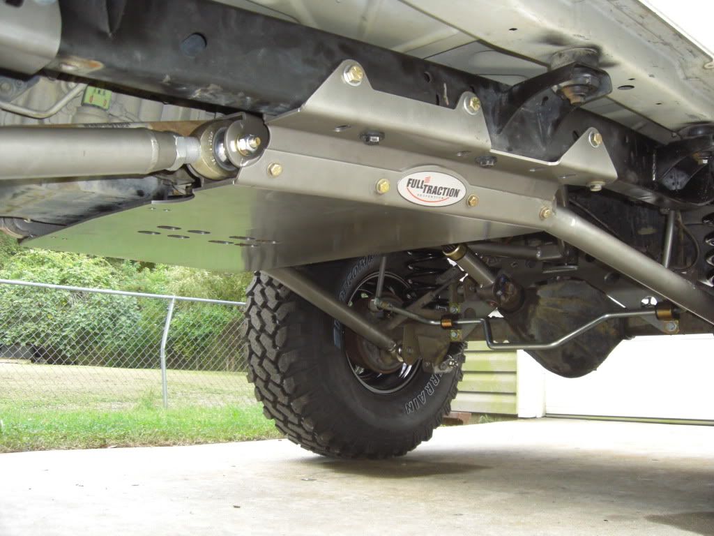

Here you can see my old bracket (which I still haven't cut off) - indicated by red arrow...
Next to the new bracket from Blaine - indicated by green arrow
