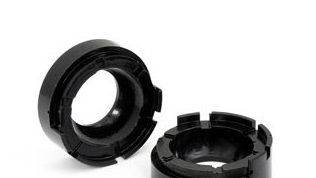

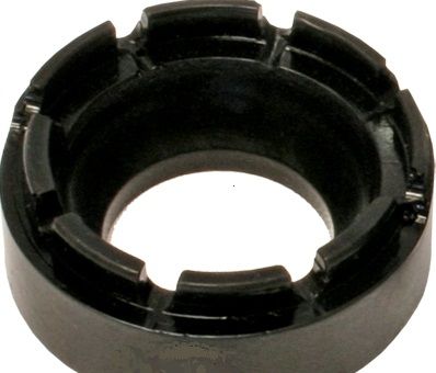

on the RC the side with the clevite is fixed and not a screw in joint, you would need a bushing of some sort you could press in.
What is it about the other end that makes the Currie better than the RC?
The Metalcoak s a different design and many say it offers a smoother ride.
one of these pics is the Currie the other the RC. I have never found out what type of urethane (if there are different types) one is versus the other. Both have the same hardness and are very similar is design. Both offer 35 deg of flex.
What makes the Currie better? People get made when I ask this. I am not saying one is or is not better but if that is the case WHY is one better than the other?

Can you answer my question? The metalcloak seems to offer a smoother ride. What does the Currie offer? When you buy the end the Currie does come assembled, the RC does not. There is a difference in how they go together but what is the benefit of the Currie?
