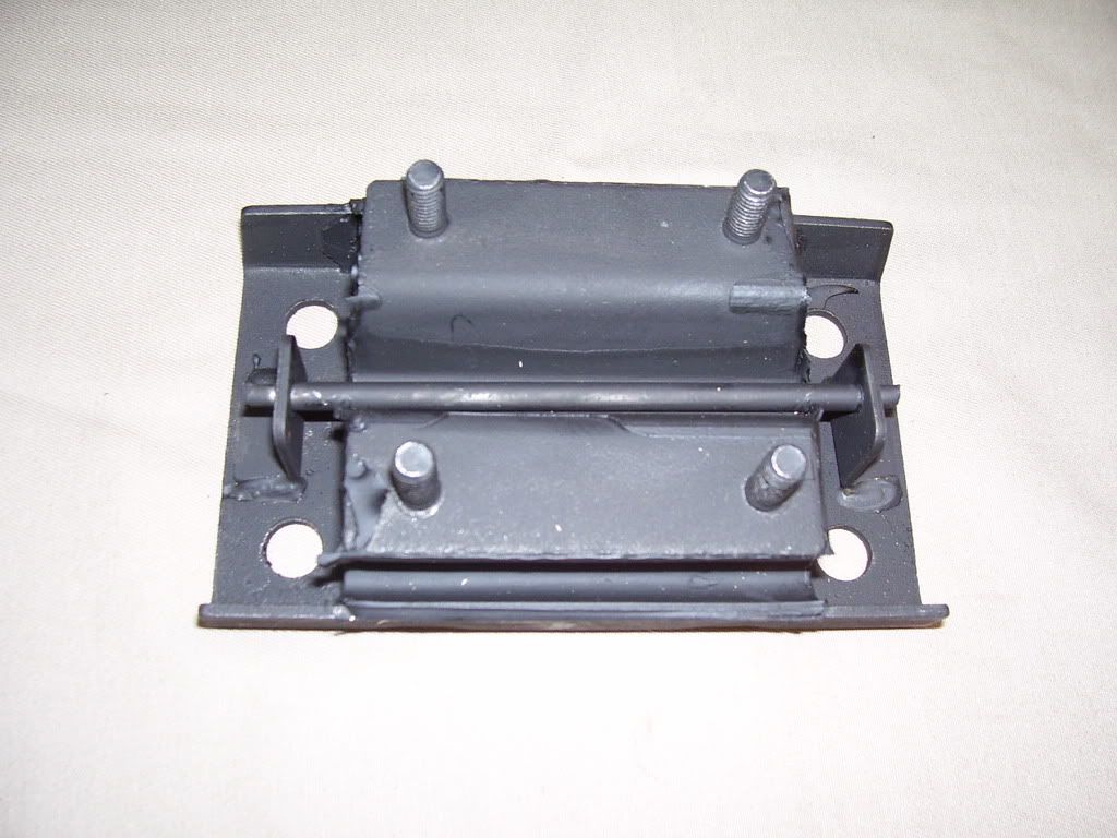

Additionally, i found a rod broken off and laying inside the tranny mount, it looks like it connected two tabs on either side of the mount, i'm not sure how it broke or whats its purpose was.
So now i'm confused on where i should look next or what else the problem could be, i'm assuming the starting problem and tranny leak are connected but i honestly don't know. Any help, advice, or ideas that anyone could give me would be greatly appretiated.

not sure about the rod you found by trans mount.the only rod comes to mind would be a shifter fork rod?

On the tranny leak: I don't think the rod is a shifter rod, it looks like it fit into a hole in a tab on either side of the mount that connects the tranny to the skid plate, i have no idea what it's purpose could be, but i'm thinking if it supported the mount, and now it's broke, that might allow the tranny to droop enough to pull it apart from the TC and cause a leak, does that sound believeable?
I guess the two problems might be completely seperate and just have occured at the same time, strange coincidence if you ask me.

you've got some weird stuff going on.after re-reading your post,i'd say the rod is a linkage rod to your gearshift selector? try moving your gearshift through the patterns of park,reverse,neutral,2nd,1st, and see how it feels.maybe have someone do it while you're under looking at linkage.
that's probably your problem.if not properly in park, your safety switch is not engaging.
that doesn't explain your leak though.

1) transmission mount needs replaced...
look here for a step by step....
http://www.rockcrawler.com/techrepor...t_tj/index.asp

3) leak between tranny and transfer case has nothing to do with either of the other two

The rod is definately the same busted one in the picture above, and it makes sense to me that it is causing the leak from between the tranny and the TC.

So i replaced the tranny mount and have not seen any new fluid leaking, so i think that issue is fixed.
