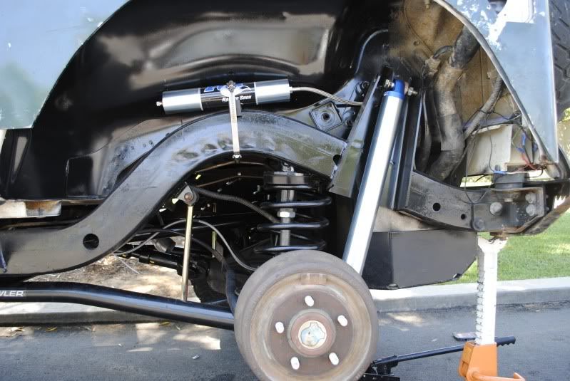

Fox 2.0 12 inch travel... got mine "used" never were installed for a great price. So far they ride very very nice. I still need to have them re-valved as it seems a bit soft. Other than that these are some beautiful shocks:

Dang those look nice. Did you outboard yourself or have a shop do it? Everytime I look at those shocks it makes me want them more and more

That is possibly the single most gender challenged reservoir mounting method I have ever witnessed. Really? A pair of hose clamps around the frame? That's the best you can do? If I were Fox and saw those pictures, I'd drive to your house and take your shocks away from you for that.
I deserve that. This is not permanent, as I have been having to swap these shocks in and out while I get my rear springs the correct length. I should not even post these pics until Im done, since I knew the mad scientist would have to stumble upon it at some point.
no update thread yet, still working on it ever chance I get to get it dialed in. Myself and a friend did all the work on my build.
