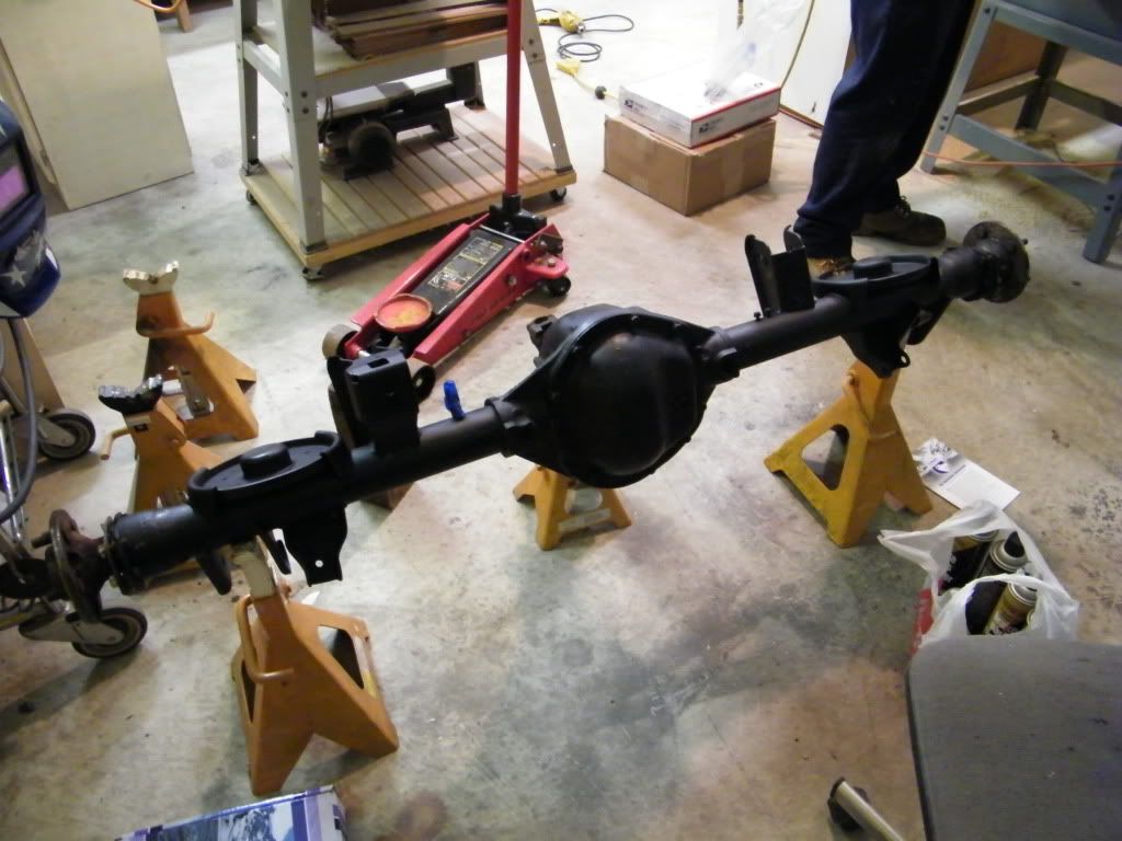

First off, Jake brought the axle over tonight and was kind enough to have already cleaned the hell out of it so there was little grease and gunk anywhere which was awesome.
For starters pull the diff cover and have a look inside. Make sure there are no crazy metal chunks floating around, chipped teeth, anything that could have gotten somewhere it shouldn't be and take out other parts. This mainly goes for those reusing your carrier(much like Jake has chosen to do... it has OEM trac-loc). I have seen a few and heard of many other D35s have destroyed the left side of the housing when the carrier bearings get worn beyond their limits and it's basically a big paperweight after that. A thick metallic jello-like substance is a good indicator of this

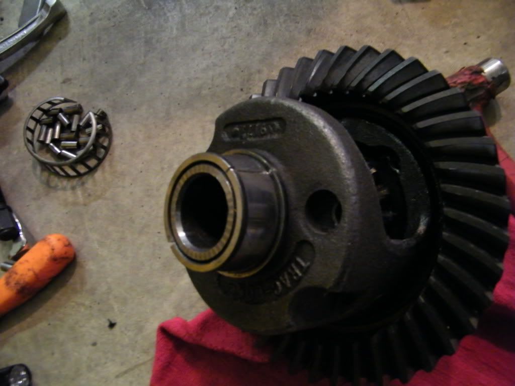

Now we're removing the carrier bearings(since we're reusing the carrier... if you are buying a full-case locker or are using a new carrier then you can skip this part).
We first cut off the bearing cage w/ a dremel cutoff tool. Cut the cage off and pull all the rollers out.
Then using the dremel, cut a line across the inner part of the bearing like this:
Be careful not to cut all the way through and into the carrier... you can cut most of the way in, then strike the gap w/ a cold chisel and hammer. This will likely split the bearing and you might be able to slide it off(with the chisel wedged inside). We had to actually cut 2x 180 degrees from each other on both bearings, we couldn't get the thing to split with just one cut. You may need/want to do the same.
You will find that under each bearing there are a bunch of shims... keep them organized when you remove them(know which ones came from left and which ones came from the right sides). This will help you later, especially if reusing the carrier.

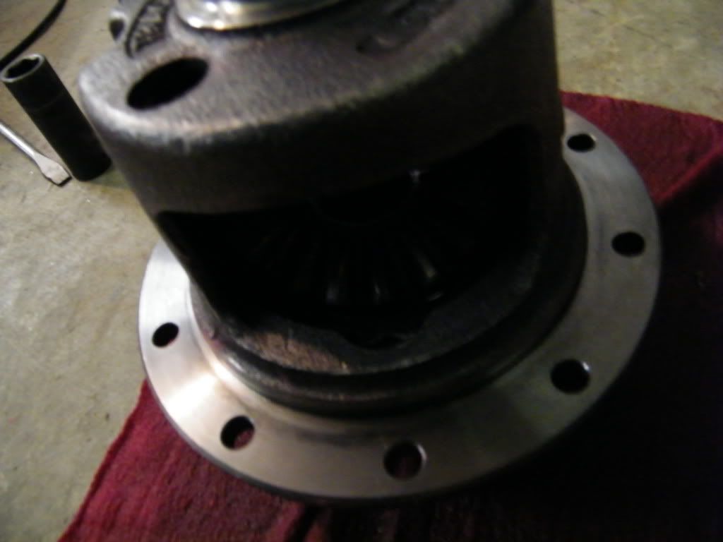

Now you can remove the old ring gear... it's pretty straight forward, remove the ring gear bolts. For us the ring gear just came right off... it might give you some trouble that a deadblow hammer could fix
Now you can clean the carrier real well... particularly the ring gear surface. Lots of brake-clean and wiping down w/ a rag works well.

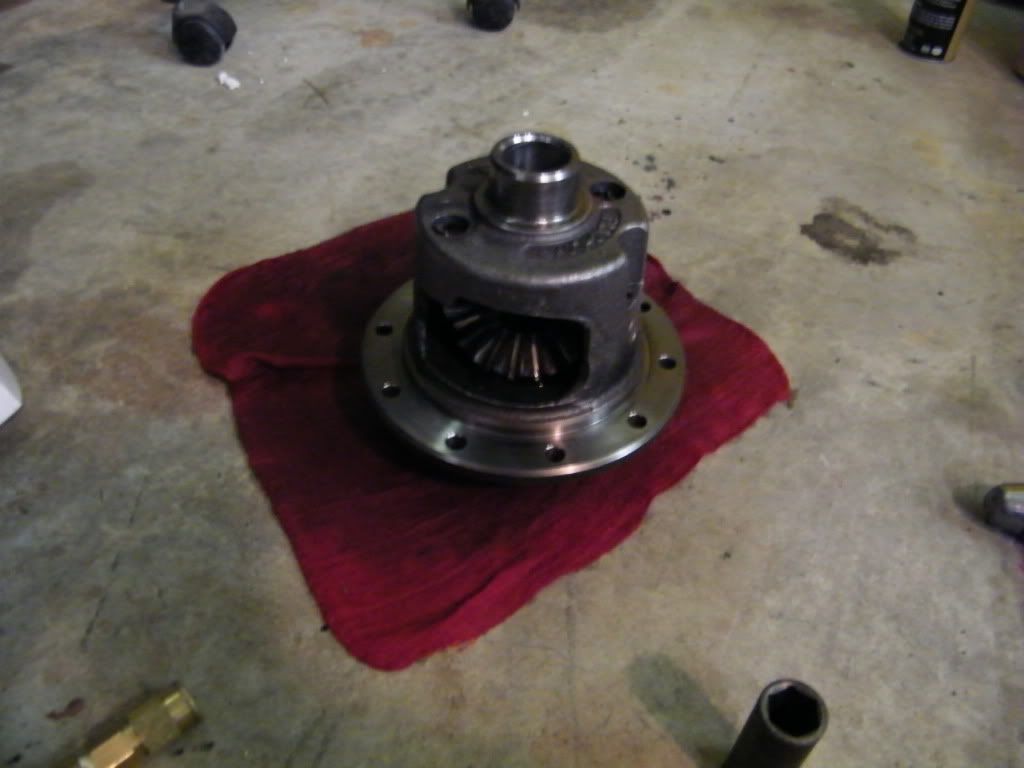

Somehow I forgot to get a pic of reinstalling the new ring gear, but it is on. The ring gear didn't want to go all the way down by just pushing(about 1/8" gap). Know it is not good to use the ring gear bolts to pull the ring gear flush... but we did so carefully. DO NOT USE AN IMPACT! Basically I finger-tightened all the bolts making sure the ring gear was completely square to the carrier the whole time. Then going around the carrier w/ a normal ratchet I only did about 1/2 turn on each bolt in a criss cross pattern(like tightening a wheel). I never had to apply more than maybe 20ft lbs at the most. It was all one handed tightening to snug the ring gear down. We will be torquing the ring gear to spec tomorrow, now is a good time to do it though. Also be sure to use red loctite! We are using what was provided in the Yukon install kit.

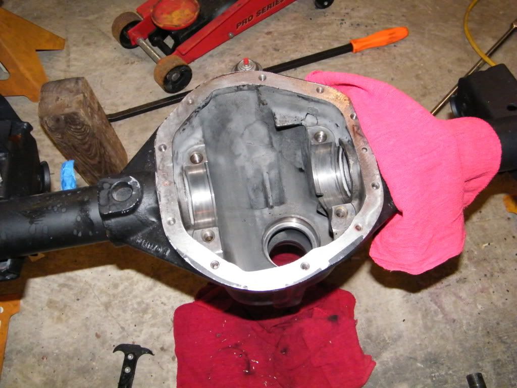

Then clean the housing!!! LOTS of brake clean! Wipe it out w/ a rag. Be sure to get any gunk that may be trapped in the pinion bearing oil passages. Pay particular attention to all the bearing race surfaces as well.
And that was when Jake and I decided to call it a night... we cleaned up and got organized to be ready for setting up the gears tomorrow...
You can see all the old parts/shims on the left(on top of a box). I will be measuring the old shims tomorrow to get a starting point.
The new parts are all laid out and labeled on the cardboard on the right. Carrier is obviously on the rag in the center. Rag over housing to keep anything from getting inside.
