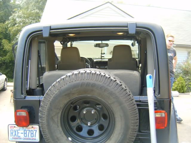

DO NOT OVERTIGHTEN THOSE BOLTS!!!!!!!!!!
or the back of your jeep wil look like this

Just got my new rear window put on today ... after overtightening those bolts ... $449 installed, privacy and defrost ... good price ... but too much for that mistake!!

i think that happened like a month ago, and i am still finding glass pieces in the jeep in random places
