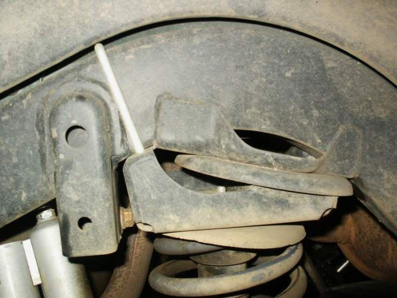

I'm doing a bunch of shopping for a long arm kit like I should have bought to start with and saw these. Anyone used them? Is there a better kit around? Are the worth it?

nth degree parts are hard to beat. If you're going long arm and want the best all around performance nth is the way to go... my rubi is littered with nth stuff along with other fabricated parts.
the spring relocators work great and are very easy to install, I've done a few and the shop is an authorized aev/nth dealer.

i have them, and have used them. but currently have them removed because it made my jeep too tall. im considering down the road of getting the AEV 3" coils and reinstalling them with a puck up front.
when id did use them though, they worked incredibly well!

I have them. They came as part of my 4.5" Nth LA system. Everything about the system and Nth products that I've seen so far is top notch.
Another option you have is to relocate the original spring seats. I believe there are also companies making the spring seats alone. These would require removal of the originals but give you a more robust seat as they're made from 3/16" material.

What they do is allow the spring to function properly by taking out the bow (inherent with rotating the rear axle) which eliminates coil binding.

That is what I dont understand or like about this "kit". You end up having to band-aid your system by adding short rear coils and front spacers, negating the gains achieved by relocating the coils.
The proper way would be:
A. Cut the welds, relocate the existing brackets and weld em back on.
B. Remove them and install aftermarket mounts.
C. French the frame,move the coils back and outboard the shocks at the same time.
Option C will allow you to use your existing coils, and outboarding the shocks will further enhance stability. Total cost would be the same as the AEV bolt-on bonanza above.
