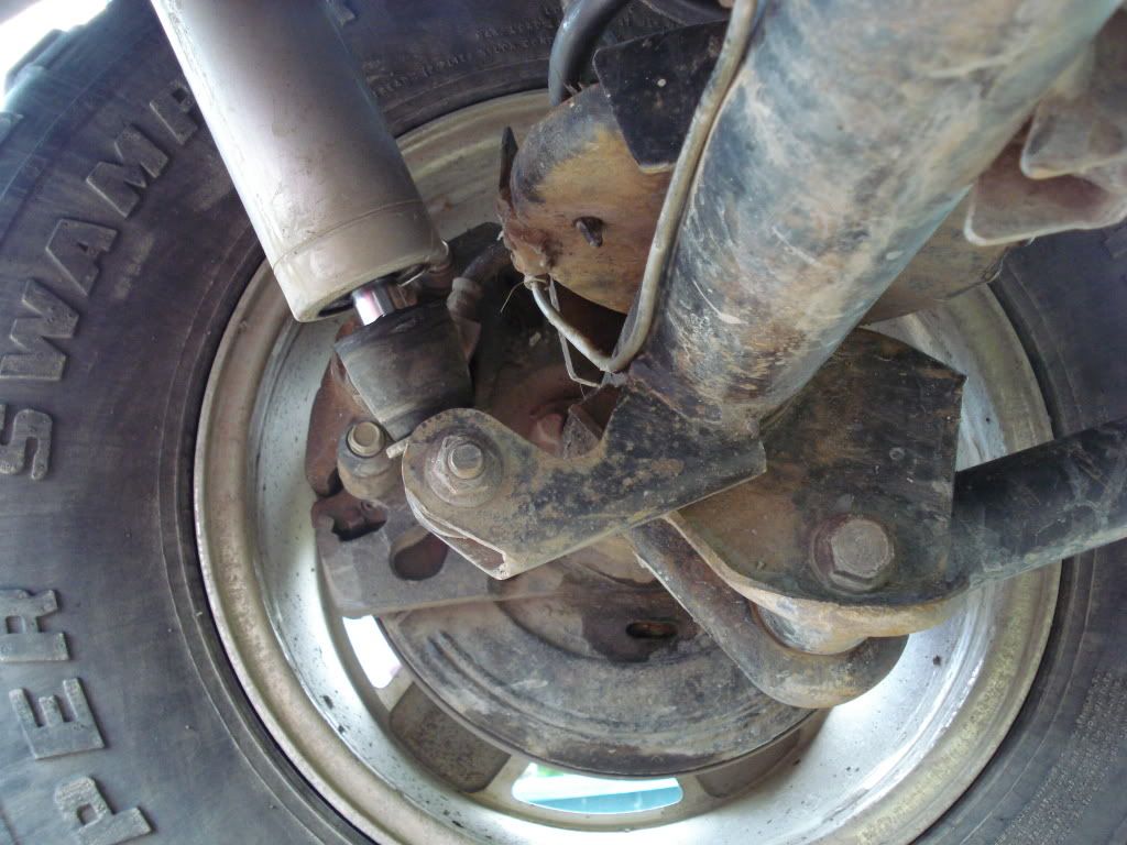

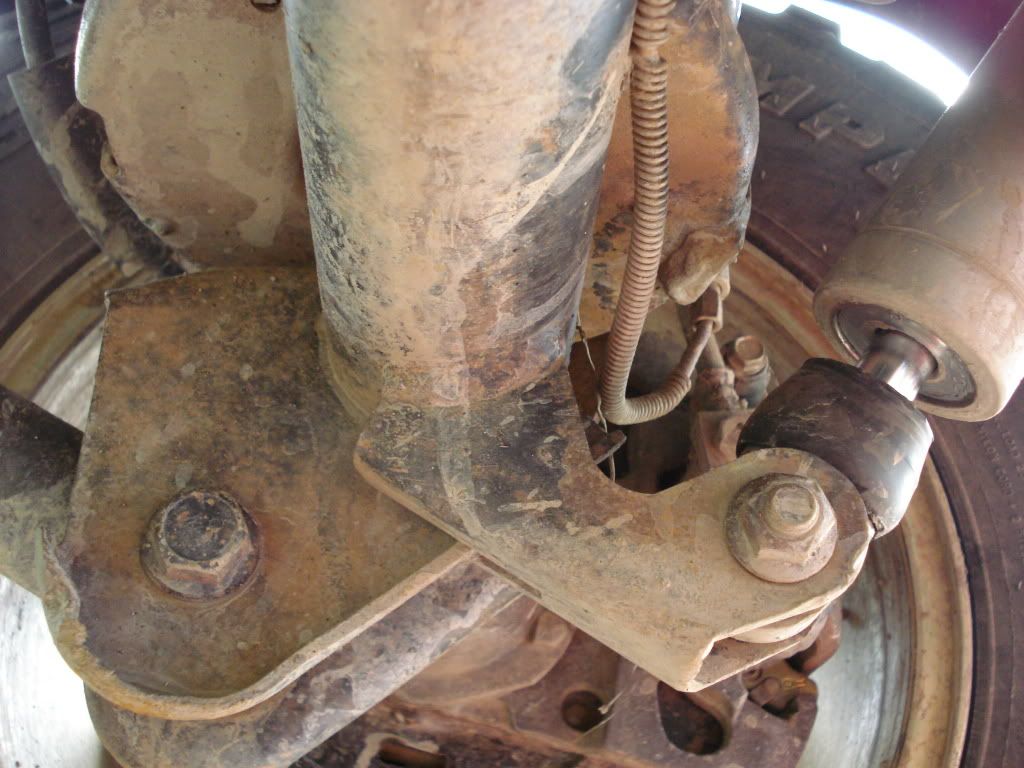

let me give you this to look at.I wheeled the shortest shock they have(which is as short as there 1.75 BB shock) 2 weekends ago and i WISH i had the travel you do.Now both bushings at the top worked themselves out of the shock eye and a tore one of the rubber bumper things in half.Now the problem i have (as you know) is not a Rc related,i am however going to move my upper mounts to fix it.
Now on to the pics,i have a 1/4 inch of travel in my rear shocks in these pics and wheeled it pretty hard and with as much travel as you have i dont think your going to damage them like you think,idk thats just me.

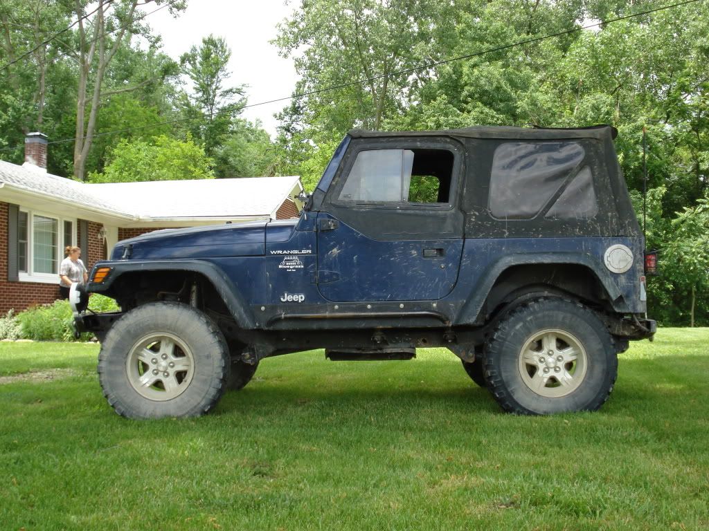

and this is how it sits rite now and i got plenty of lift there no debate there.
actually if you had some uptravel, the upper bushings would not have gotten destroyed... those lower shock mounts look like wj grand mounts.. if you're intersted I can send you some mounts to weld on or a pattern to make em yourself... they'll make a completely different jeep outta it. i'm not interesed in compensation, your lower shock mounts are just plain wrong, I feel for you, let me know, I'll get a pair cut out and in the mail...
