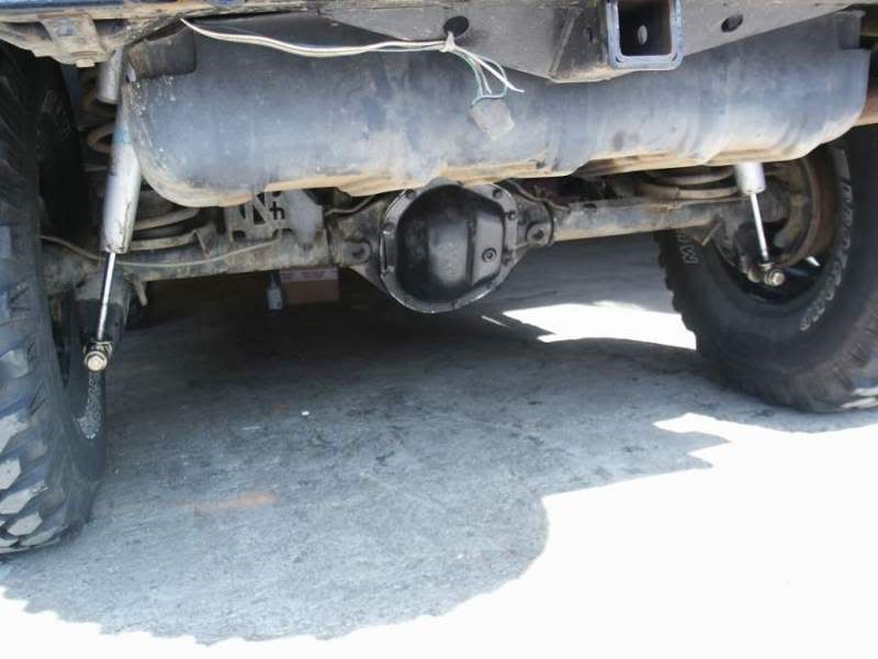

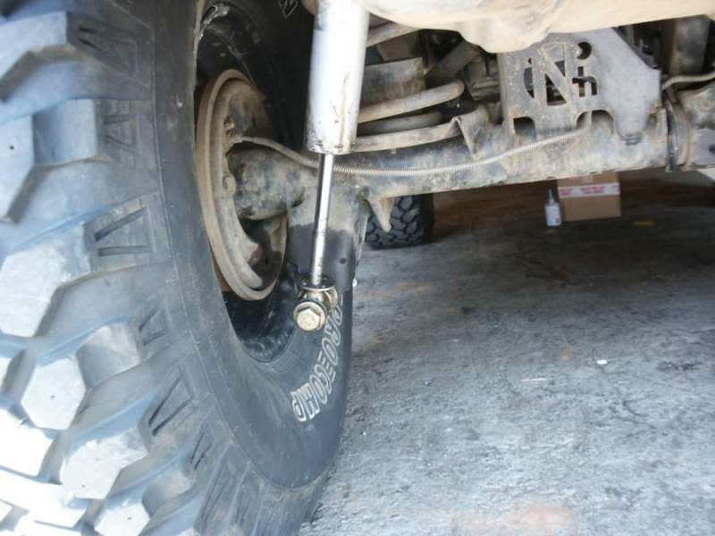

here's pics of the nth degree shock shifters....
I made relocation brackets today and installed them on portlandcj's RC 2.5" equipt tj... it went from 3 1/4" max uptravel to 4 3/8" without causing a negative effect on the downtravel... they are now hung about the same as the nth brackets above, one thing to consider is, the uppers should also be moved, shifting the shocks outboard puts the body of the shock dangerously close to the frame, although the rc shocks don't hit so far... there is now tons of room at the usual contact points from the fuel tank and exhaust. portlandcj's shock has the paint rubbed off of it from hitting the tail pipe..
pics of the new home brew outboard brackets later when they get downloaded...
