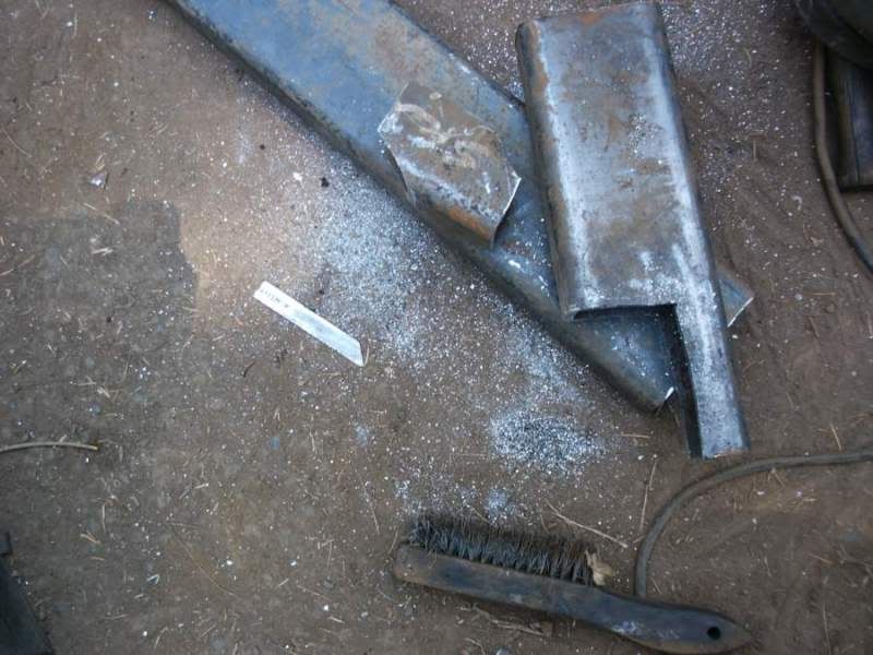

here's what I make from scratch with a grinder and sawzall... a complete outboard mount is about the only solution to having lots of uptravel and down travel with a small amount of lift.
this is what you end up with as far as up and down travel ... I have 2.5" rancho springs BTW... 2 more inches are available on mine if I removed the 2" bumpstops, which are there to clear 37" tires.
in comparison to the stock mounts... shock shifters will still hang as low as the stock/extended mounts you see still on next to my high clearance, long travel mounts.

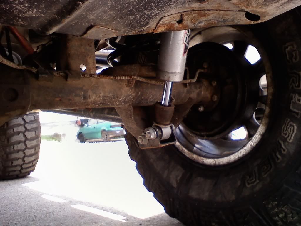

lol, here's what shocks that are too long, bottom out and don't have properly set AXLE bumpstops do to the shock mounts ...
and yes I know... the pic is of an xj.. same thing happens to the tj.
