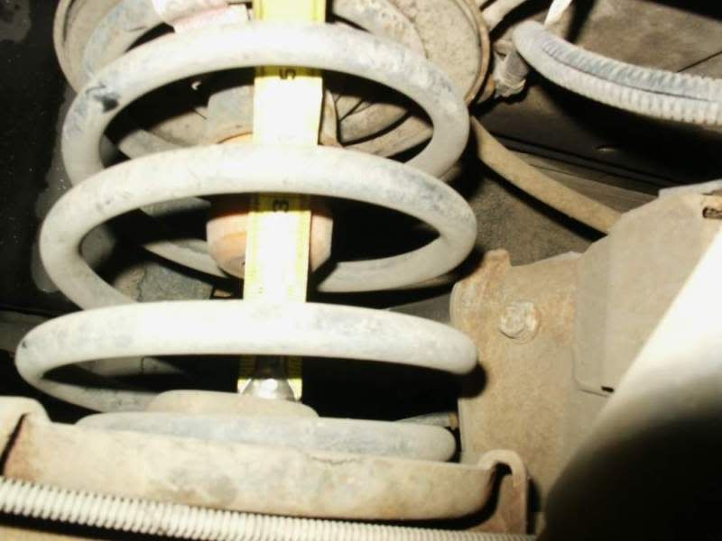

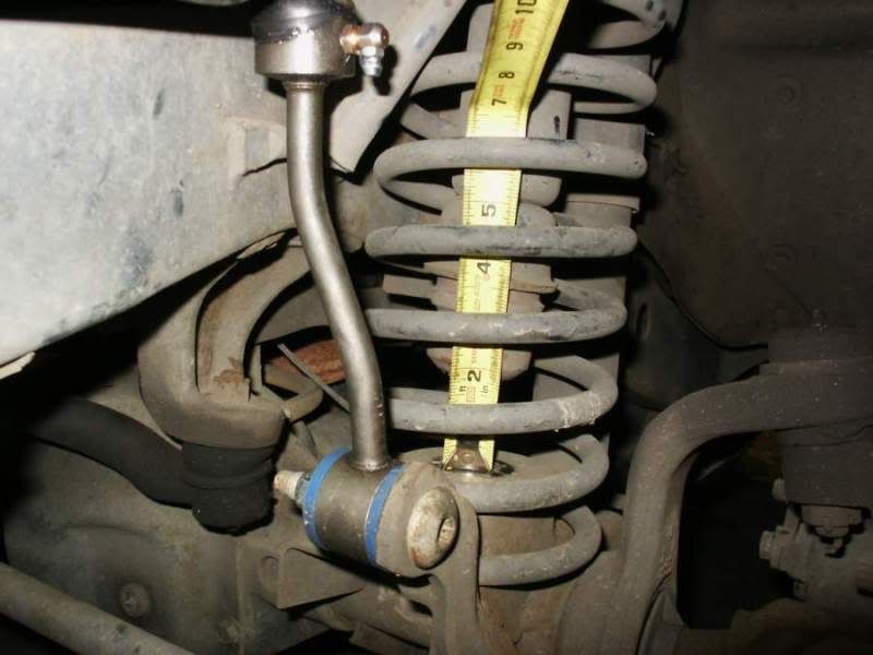

this is the measurements of a stock X tj.. the front spring rate is 128, the rear spring rate is 104, which is a common and good rate for a stock 4.0 tj. a rubicon/sahara model will have 129-130 front and 104-106 rears..
front... 3.75" max, 1.75" to bumpstop contact.
rear, 4" max, 2" to contact.
